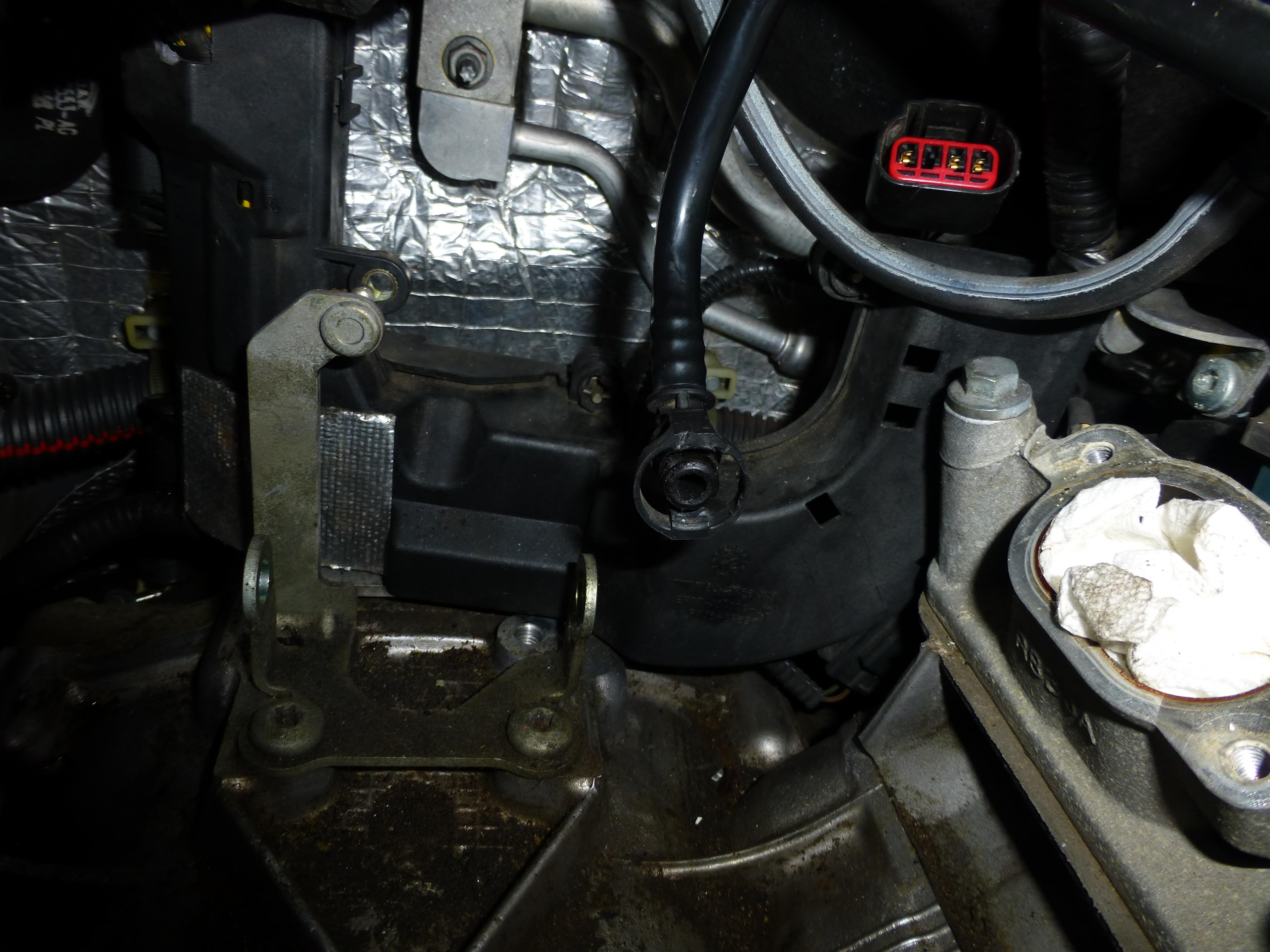

I need help on this issue please.
So far I have managed to get to the EGR assembly and have removed the two bolts, dropping one down the back somewhere. However the very thick inflexible wiring harness encased with a rigid plastic "holder" prevents me
from raising the EGR up and out.
The diagram from the JTIS shows ample room but have a look at the picture of my set up where the rigid plastic "holder" actually rests on the top of the assembly.
Despite dislodging and cutting harness ties I can only move the harness about 1/2". Not enough to get the EGR out.
Any suggestions?
Attached Thumbnails Super charger removal problem-jagegr-001.jpg   Super charger removal problem-p1070196.jpg

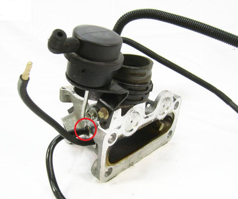

Another question. I broke the collar on the air intake elbow pipe. Its the top pipe in the top diagram. No way could I compress both sides of the collar to slide it off.
Anyone know the part #?

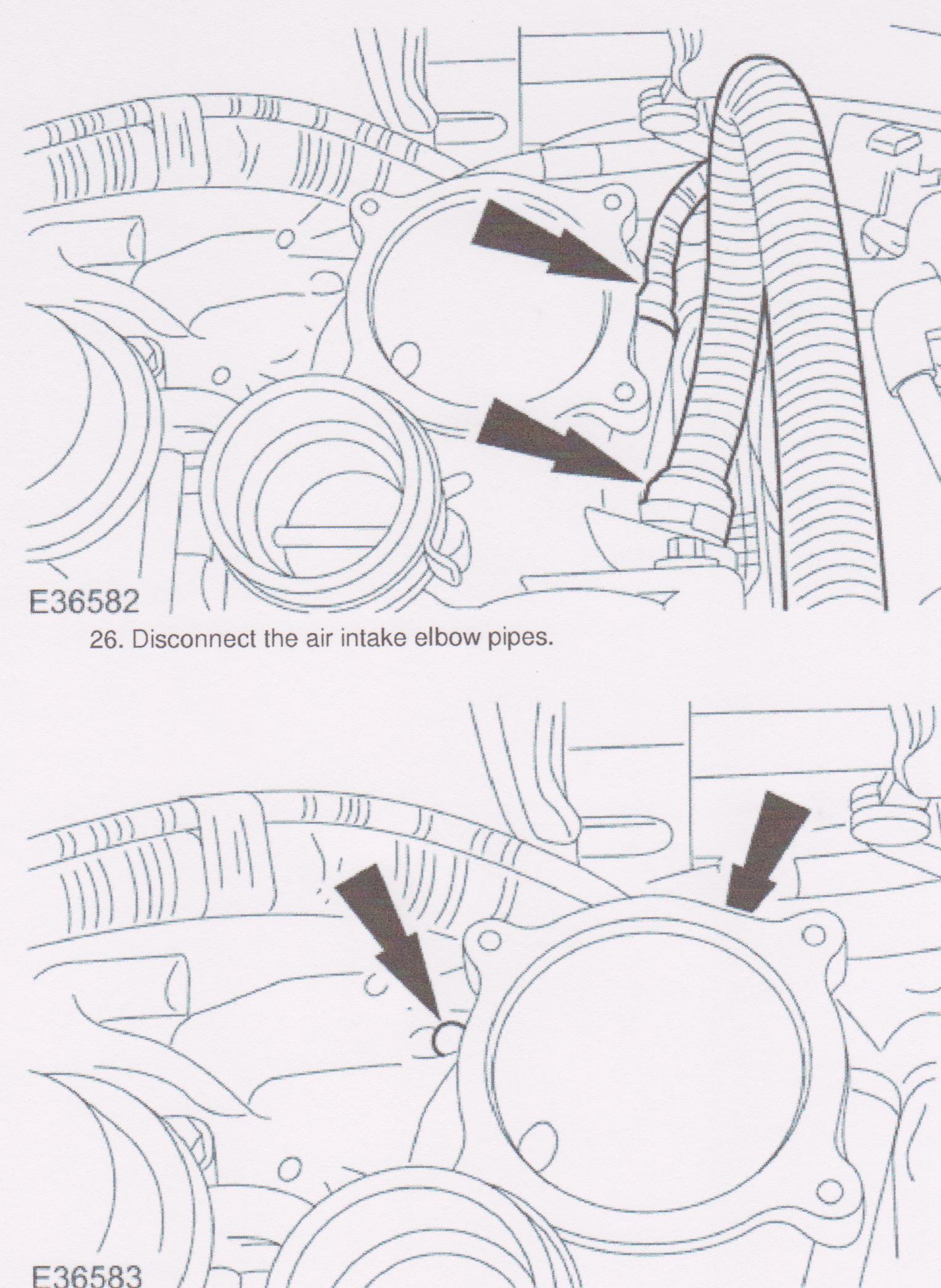

So broke off the plastic tab and cut tape off so that I could lever the wiring harness back enough to lift up the EGR assembly. Only issue is that it will not lift out all the way. I am thinking that it may be the electrical connector.
Problem there is that I cannot access the connector to release it in its current position. I was hoping to pull the whole thing out a bit so that I could release it.
Also in the diagram below showing the EGR valve tube retaining nuts where are these located and how do you access them?

Continuing with the saga. I did get the EGR electrical connector off using two long screw drivers one to press in the clip and the other to lever the connector off.
Now the EGR unit will lift up about 1/4" or so and rotate 360 degrees easily but will not lift out. Something obviously is catching underneath inside the housing.
JTIS seems to indicate that it will come out.
I can now see the two coolant pipes attached to the housing and again access is the issue. Releasing the hose clips with the EGR unit in place looks impossible without doing some brute force damage.
I presume the EGR pipe nuts are under the hoses?

I never had to remove my EGR completely You need to remove inlet from supercharger and EGE hookup, vacuum lines...Then remove inlet. Once you get the inlet out of the way its pretty much straightforward.

Cannot see the elbow bolts as indicated in post #2 bottom diagram.
I removed the EGR tube bolts/nuts and was able to push it out of the way.
I removed the 4 bolts that go thru the elbow into the back of the SC.
When I look directly down and around the opening to the elbow I do not see any bolts at all just empty space going down to the engine block.
I cannot feel any bolts either but I know something is holding the elbow in place! I do feel the MAP plug at the back.
Where are the two bolts indicated in the JTIS diagram one at the passenger side of the elbow and one at the back and under by the look of it.?
Oh I was able to unscrew the nut on the back of the elbow that holds the wire harness plastic "shroud" so was able to push the harness back quite a bit.
