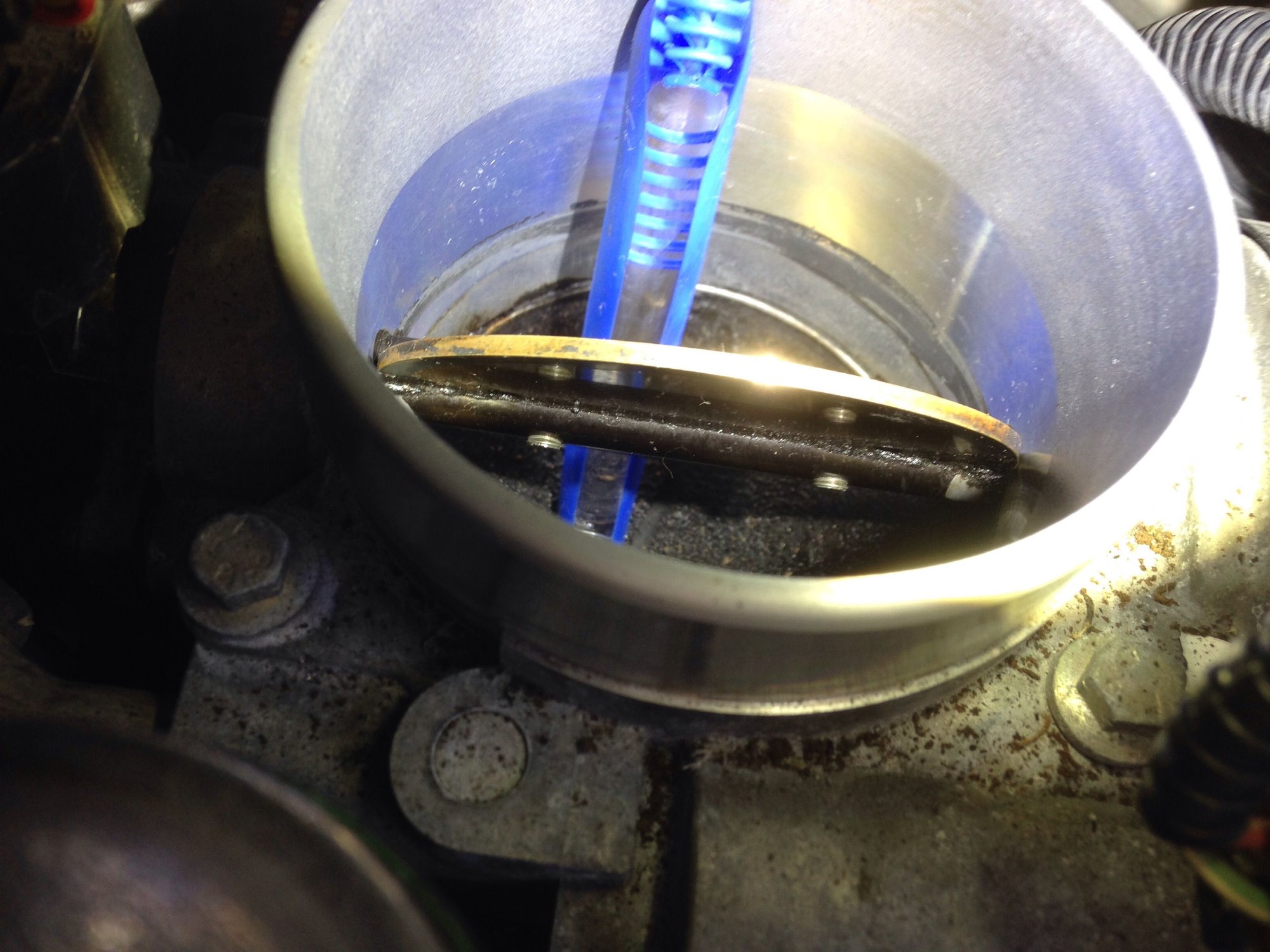

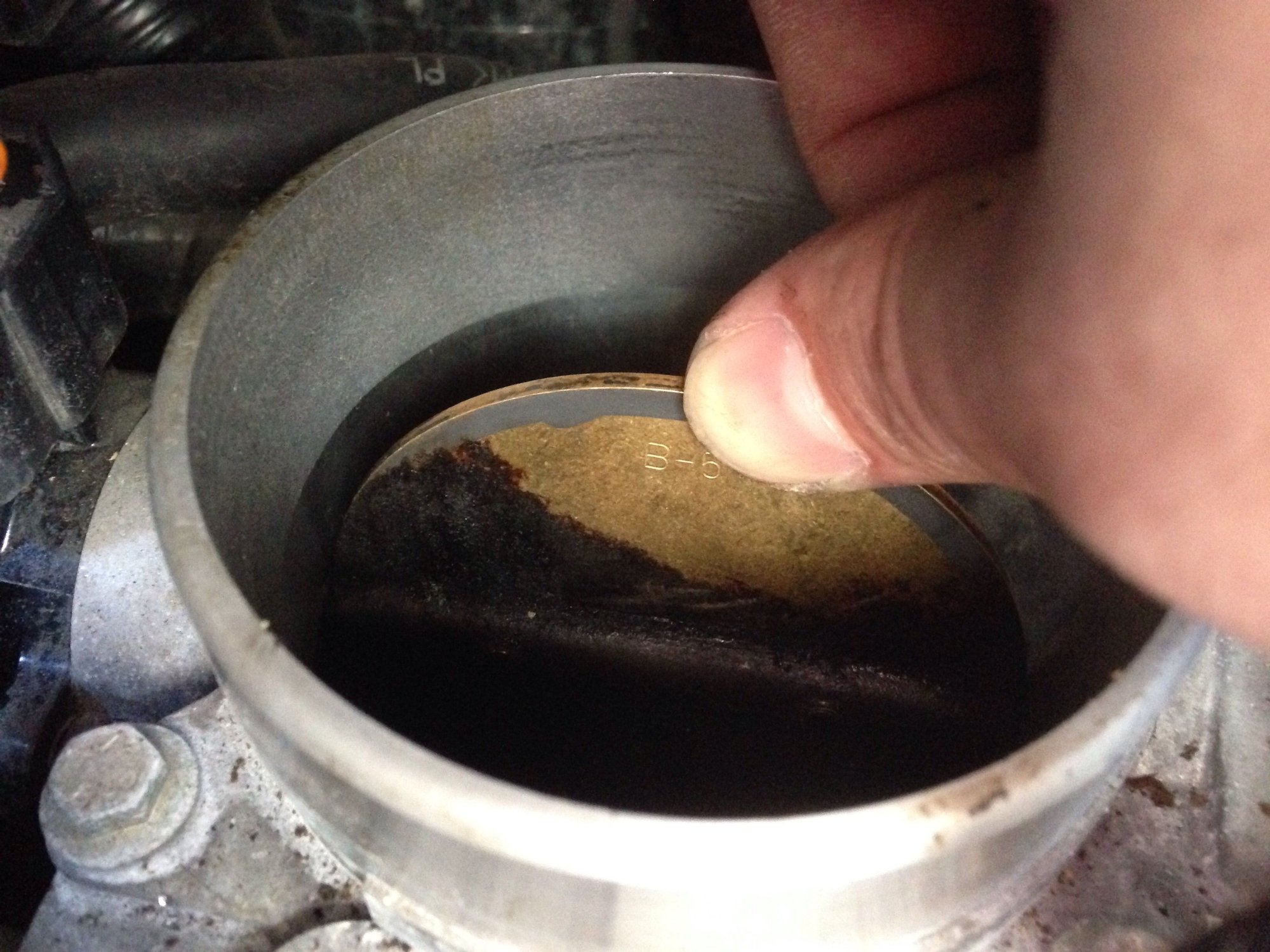

Never mind that last question lol i got it off. This is the TB completely as i found it, Untampered with. It appears not to be closed all the way.. Idk if thats normal. Ive read that the position sensors are a regular problem so maybe it looks like theres some gunky stuff just out of view so i guess ill clean it

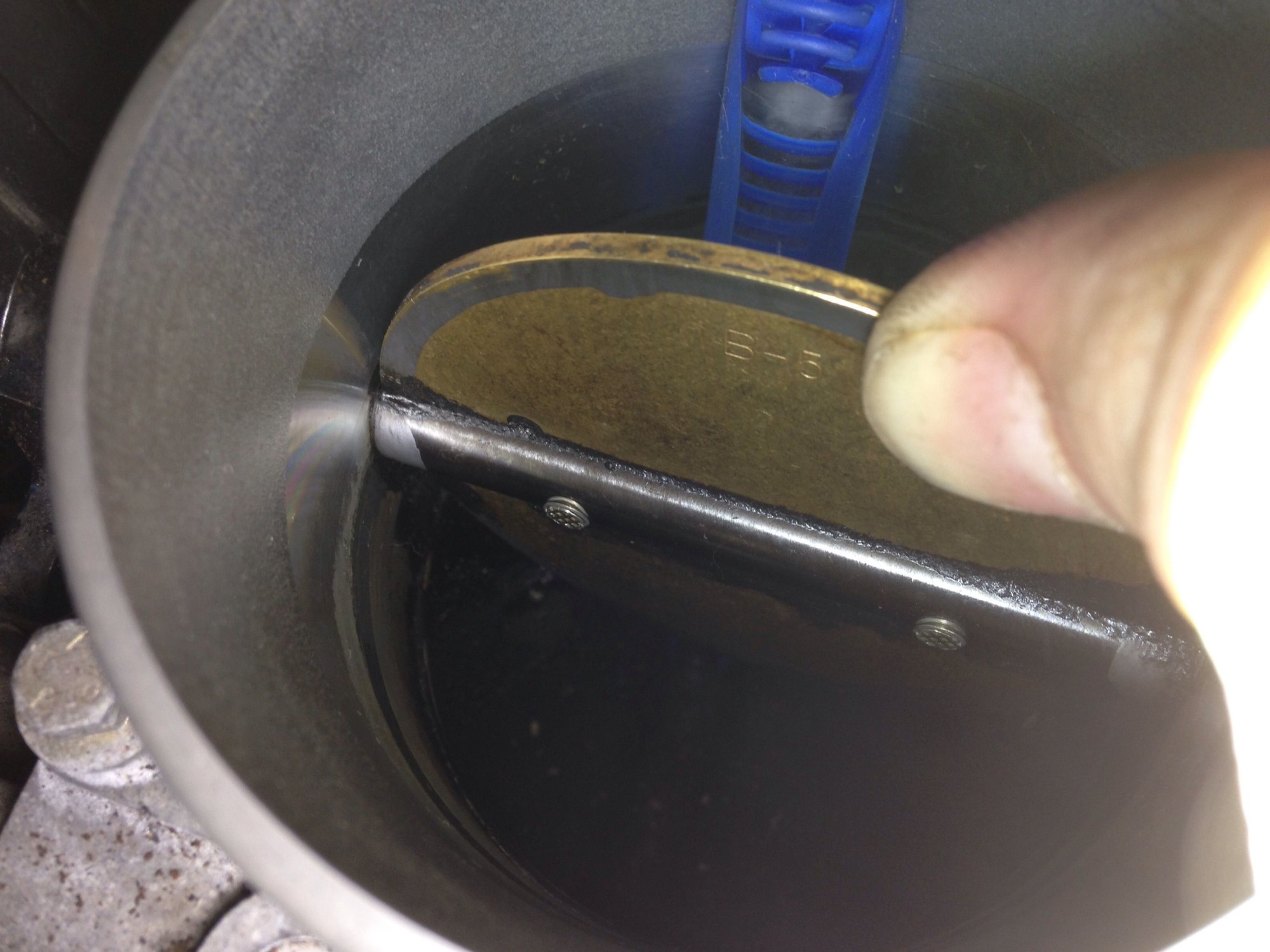

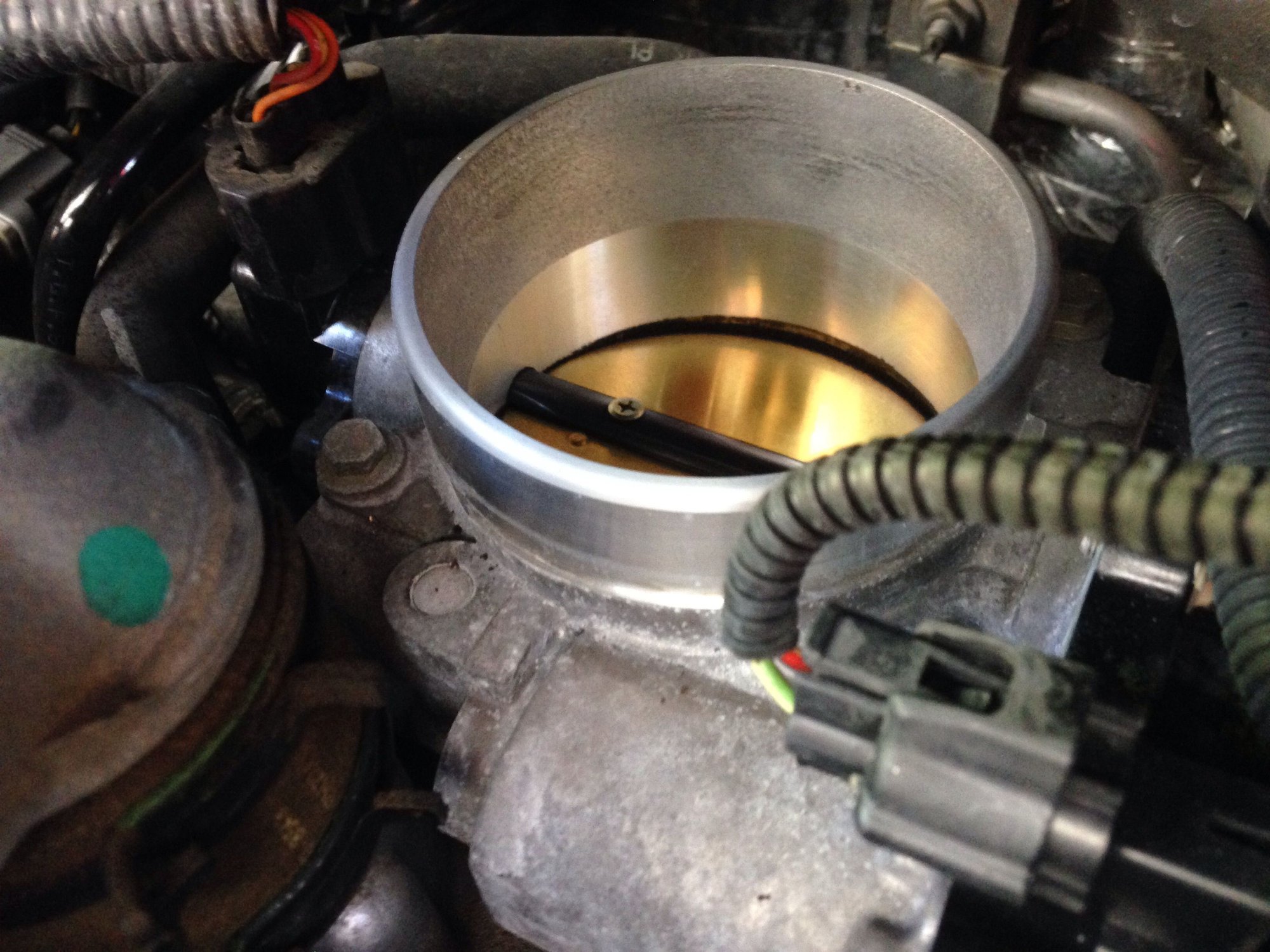

Here is some nastyness, i cleaned it up as far as i could reach so that the butterfly valve is clean on the bottom side (the special coating wasnt harmed) and where the valve contacts the body is all cleaned up so hopefully that helps something. Im about to put some high Octane and a bottle of injector/fuel system cleaner in it and keep my fingers crossed. I guess it cant hurt
Toothbush fits just right to hold er open<br/><br/>I broke the handle in half on another one to clean with (it was too tall to move up and down)

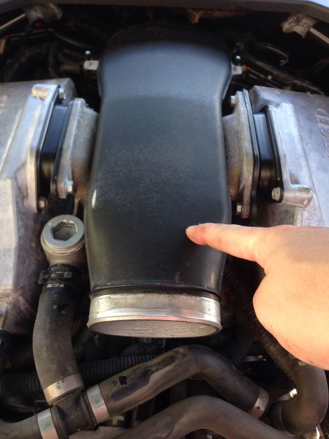

Just curious, did you paint your intake runner?

Nope i probably need to now though. I have always cleaned engines with that stuff from autozone or advanced called Super Clean... Well appearently theyve made it alot stronger and you have to be carefull what you spray it on because now it trys to eatup Paint lol

That's odd, my intake runner is the raw aluminum color, not black. I have a 2004 XJR too.

Some cars have black intakes, some raw alloy, same for the STR. I believe the very first cars got black, 2003 & very early 2004. Mine is a May 2004 build and has the raw alloy intake.

The gunk on the underside of the plate is pretty normal, here's some pictures of mine https://www.jaguarforums.com/forum/x...29/#post954116 that was the original throttle body with around 105'000 miles.

Inthink the film or coating survived intact. When i got done it looked like the only thing i removed was the oily black sludge stuff. Input it all back to together and it was idling wierd. I would rev it up and when i let off the rpm would drop back down but stop at 1000 then pause and then slowly drop down to around 5 or 600 (as normal). Ive driven it all day today and now it seems to be back to normal. I dont think anything i did helped anything but help the Bandaide company (everything is sharp under that hood) lol. Anyway the engine feels strong now and smooth. I had the check engine, DSC, Abs, traction control, cruise unavailible, gearbox fault, restricted performance messages starting a few weeks ago and have been trying to eliminate things that could be. autozone scanned and told me a MAF sensor, so i cleaned it to no avail and thats what sent me down this rabbit hole..... Today i checked the ABS wheel speed sensors with a ohms multimeter and found one of them to be bad so i think that should take care of a few of my problems.
