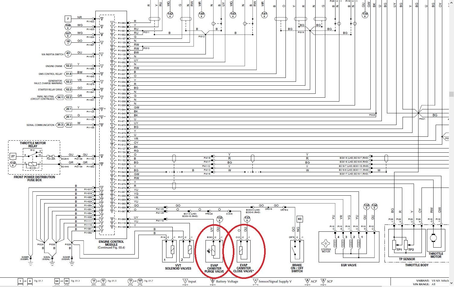

Check you have 12V supply right through to evap canister purge valve (no rat chewed wire somewhere), if so, then you might have a failed FET in the ECM due to it driving into a shorted original purge coil.
Note: For NAS vehicles the 2004 V8 schematic also refers to a "evap canister close valve" also supplied via F14 but driven from a separate control line from the ECM (Reference Fig. 3.3 in the 2004 schematic)
You might want to check that this is operating properly as well.

slave relay r9 powers a bunch of stuff and then the valve is pulsed to ground directly by the ecm. if the low side driver is shorted it’ll light a hot test light all the time with the key on
