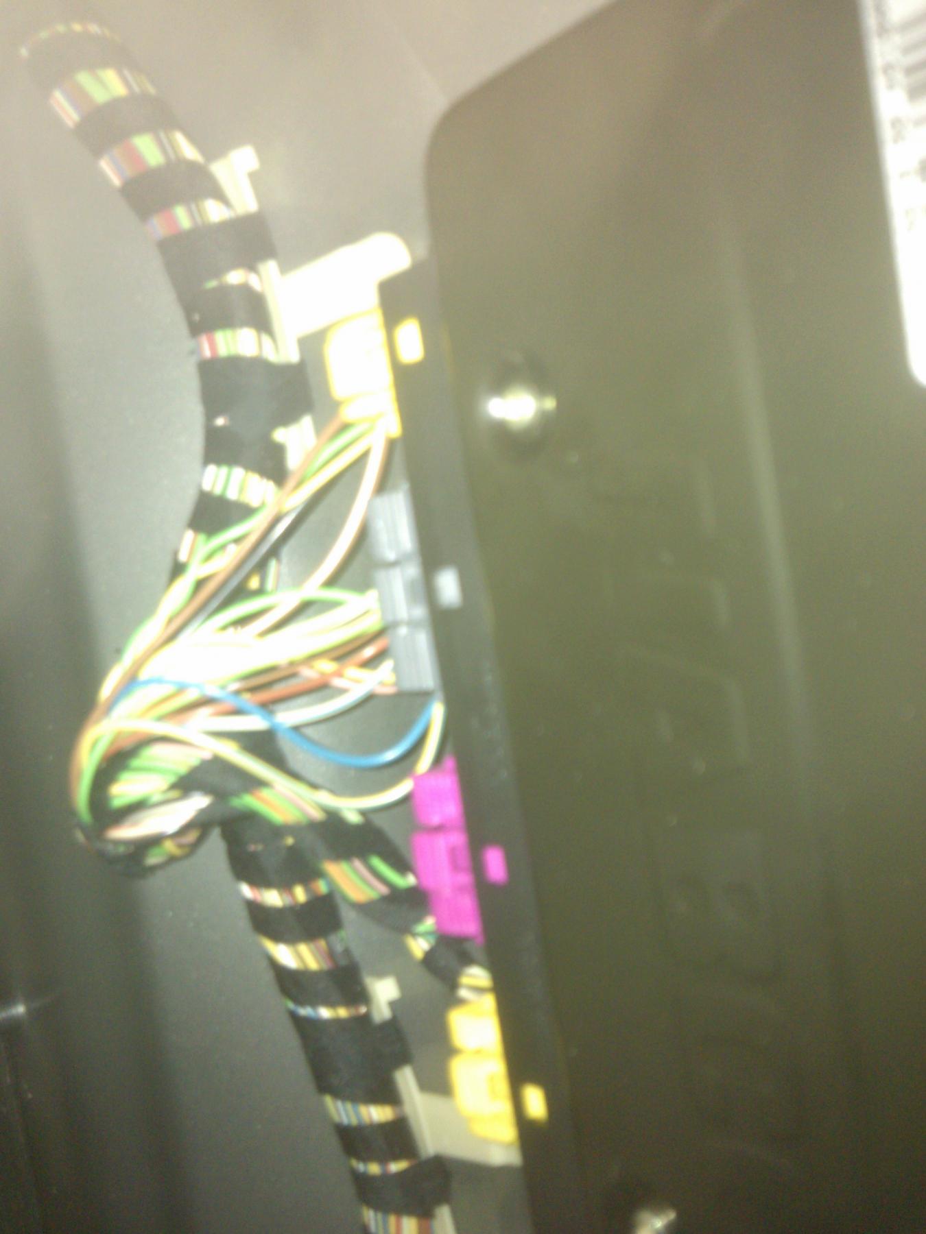

Old Aug 14, 2014 | 04:51 AM
  #35
nebelfuerst's Avatar
Joined: Aug 2012
Posts: 305
Likes: 60
From: germany
Yes, it was ASM.
I attached a foto of my connectors of ASM.
I read, that one connector must be CR91... but neither on the plug nor on the cable I can read "CR91".
So I ended up measuring the resistance of wires between ASM and valve block to identify the correct plug.
Slightly OT:
I opened my ASM and recorded with IR-Cam to see what Mosfets get hot when emptying different parts of the system.
See pic.
It's pretty hard to reverse engineer the ASM. Is there a schematic available ?

Old Aug 14, 2014 | 09:06 AM
  #36
Don B's Avatar
Posts: 20,530
Likes: 15,303
From: Crossroads of America
Originally Posted by nebelfuerst
Yes, it was ASM.
Hi nebelfuerst,
The actual connectors are not marked with those numbers; the numbers are strictly schematic identifications. Page 31 of the 2004 Electrical Guide (page 33 of the pdf document) shows a diagram of the ASM and identifies each connector. CR91 is the largest connector with 18 pin locations (I don't know if all 18 locations are used). Also, on the page before each electrical schematic is a list of components, connectors, relays, grounds, etc. For example, on page 76 of the pdf document in the list of components for Figure 05.3, CR91 is identified as an "18-Way / Black" connector attached to the Air Suspension Module.
I haven't found one, but you might search the various Wabco websites in case I missed it.
Cheers,
Don
