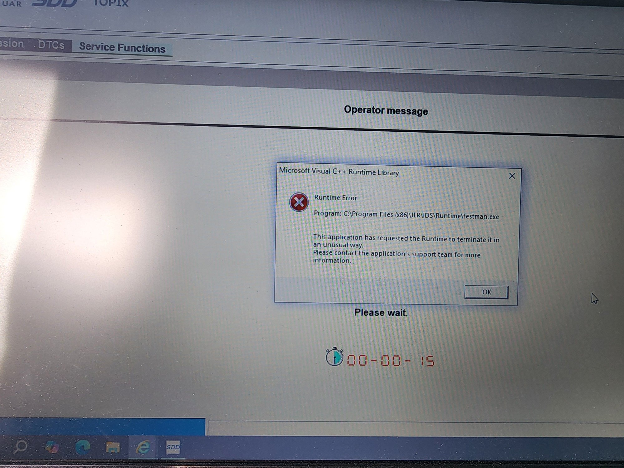

Hello everyone, my ECM need to be reprogrammed, but using SDD it flags a runtime error overtime i attempt to programme it.
Has anyone got around this issue?

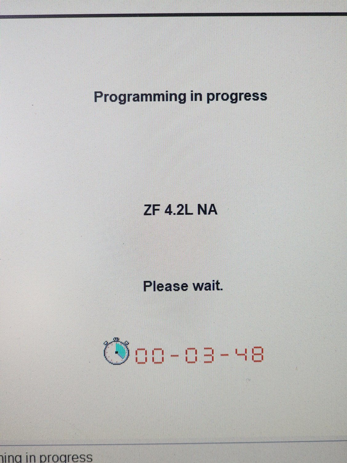

also for further Information when I programme the TCM it states 4.2 NA, mine is super charged, this may be because the Engine ECU is data is incorrect.

I can derive that your Jaguar has a 4.2L supercharged engine, but I had to visit your Public Profile to learn the year and model of your car. I have moved your thread to the forum for the X350, which is the Jaguar factory project code for your 2004 XJR. Since this information is often critical for providing the most accurate replies, and since most members won't bother to visit your Public Profile, it helps if you will visit your User Control Panel and Edit your Signature to add the year, model and engine details so they will show up in all of your posts.
Also please let us know the following:
1. Which version of SDD are you using?
2. In which version of Windows are you running SDD?
3. Are you running SDD natively or in a Virtual Machine?
4. Which OBDII Vehicle Communication interface you are using? DrewTech Mongoose or Mongoose Pro, Mongoose Clone, Ford VCM, or?
5. What is the current capacity of the low-ripple power supply you are using to prevent battery voltage sag and ripple while programming?
Also, please tell us why your ECM and TCM have required reprogramming. Have you replaced them with salvaged units, or is there some other reason?
As many members of these forums can attest, when using SDD, it is very easy to "brick" your ECM or TCM (to brick is to make inoperable and unrepairable). But given the Visual C++ Runtime Error you are receiving, I suspect your problem is with the SDD installation or VCI driver, or a problem with the Microsoft Visual C++ runtime libraries. (maybe the version that came with your SDD package is conflicting with the version that was already installed on your computer?). Once we get your thread moved, perhaps one of our tech-savvy members will chime in.

Thank you very much Don for the information and also for sorting out where my thread is put, my first post so i made a hash of it haha.
I will delve into my SDD set up and get the information uou asked for, I to believe ot is more the software on the laptop s I had a massive update last year and now this has happened.
My supplier is working on it first to see if it can be fixed, the ECM and TCM are the originals to the car I just have p0610 code so need to reflash the modules together as they look corrupt.

In the photo of the DTCs from SDD, it appears the slide bar at the right of the screen is just below its mid-point. If you slide that bar all the way up or down, are there any more DTCs stored?
Based on the Visual C++ error you are receiving, I still suspect yours is a computer issue and not a Mechatronic/TCM issue.
I am attaching a document that lists a few things to double-check after replacement of the connector sleeve.

Thank you Don, no there were just 2 modules that the SDD can't communicate with, RSM and Park module, another set of issues on the lost to fix.
I will check out the link.
unfortunately i do not have WDS and do not have a link to Tech support as i left the dealership a while ago, luckily for all my old collegues they too escaped, so can't even ask them to.
i have changed many VID blocks on Range Rovees etc back in the day, with tech support but i cannot access this anymore.
thank you.
Glenn.

With earlier versions of SDD, you do not need to connect to Tech Support to get update files. The files are stored in a library on your hard drive. The version I use for X350s is JLR SDD v.131.03. If I recall correctly, I run this package in a Windows XP Pro virtual machine on a Windows 7 laptop. Before I start SDD, I change the laptop date to August 1, 2012 and disconnect from the Internet to prevent SDD from attempting to connect to check for an update.
I have tried later versions of SDD, which are generally faster than 131.03, but they always seem to encounter difficulties of one kind or another, including wanting to connect to Jaguar via the Internet.
