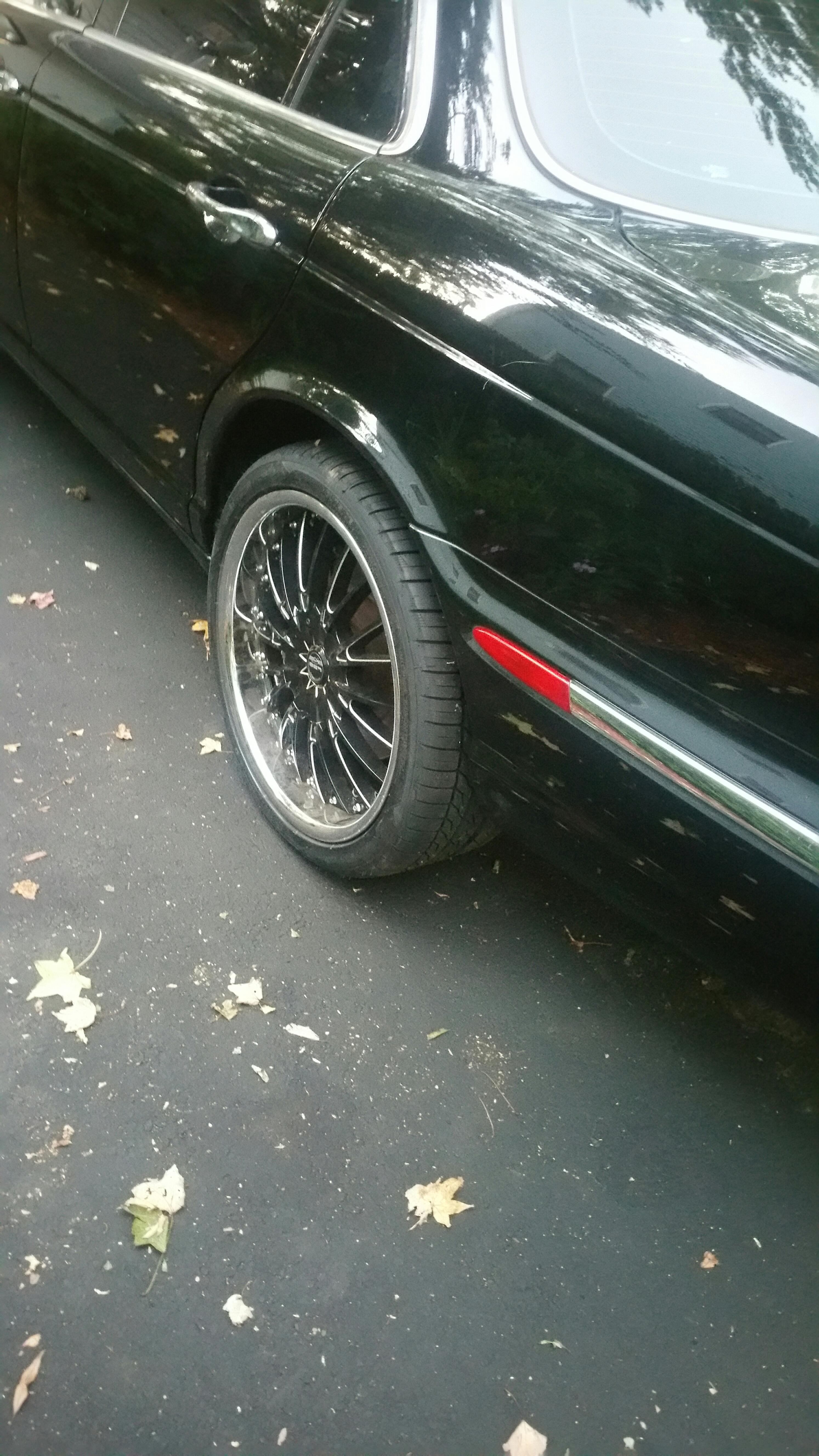

My neighbor (mechanic) installed and balanced my new Nitto Motivo 20" tire today...
Attached Thumbnails What did you do to your X350/X358 today?-20170929_184151.jpg
