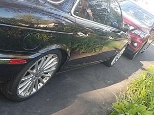

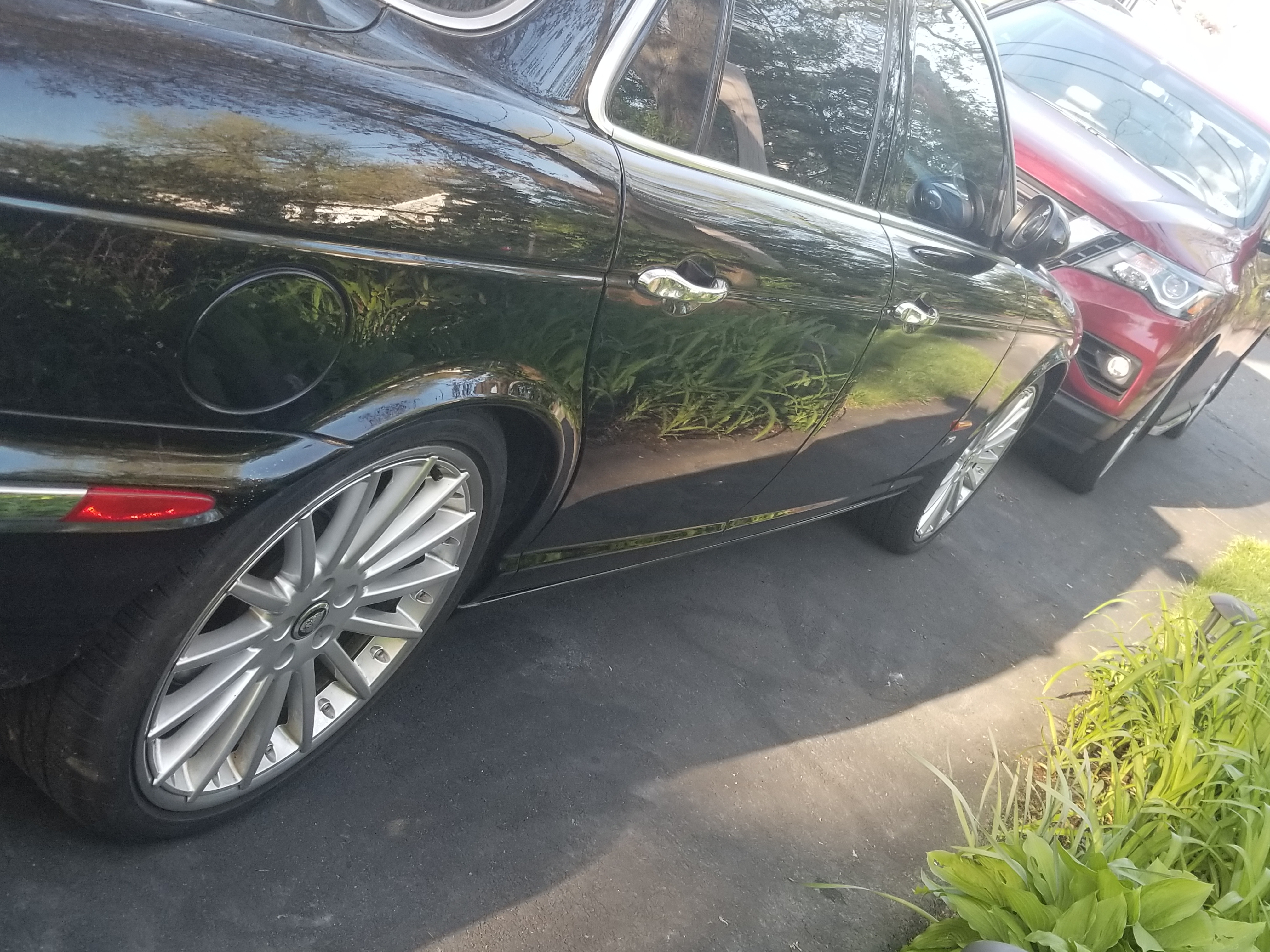

I removed the side trim off my 04 XJR.
I had the car for 2 plus years and didn't realize the driver's side trim was removed but the passenger side trim was intact.
I think the car looks better w/o the door trim. What a bear to get off and polished...
Attached Thumbnails What did you do to your X350/X358 today?-20200428_180628.jpg

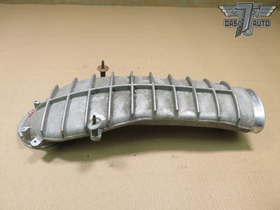

Default Planning on replacing my SC inlet pipe.
Just purchased this Range Rover L322 SC inlet pipe cheap. Will replace my original with this less restrictive one.
Old May 6, 2020 | 04:28 PM
  #958
abonano's Avatar
Joined: Mar 2012
Posts: 4,759
Likes: 1,435
From: Hazlet Township, NJ
I've done this.
Buy the 4" × 3" rubber coupler reducer from Advance or Autozone. Double clamp each end...
The best one is: Spectre Performance. (I used another brand and didn't feel comfortable..)
You need to grind down the ribs at the end near the throttle body about 1/4" to 3/8" lower to clear the brace. From recollection go back 3 rows..
Last point - it will sit kind of crooked after tightening down. (Prompted me to take mine off)
Found out afterwards you have to bend the metal tab up front a bit to straighten out the tube "visually".
