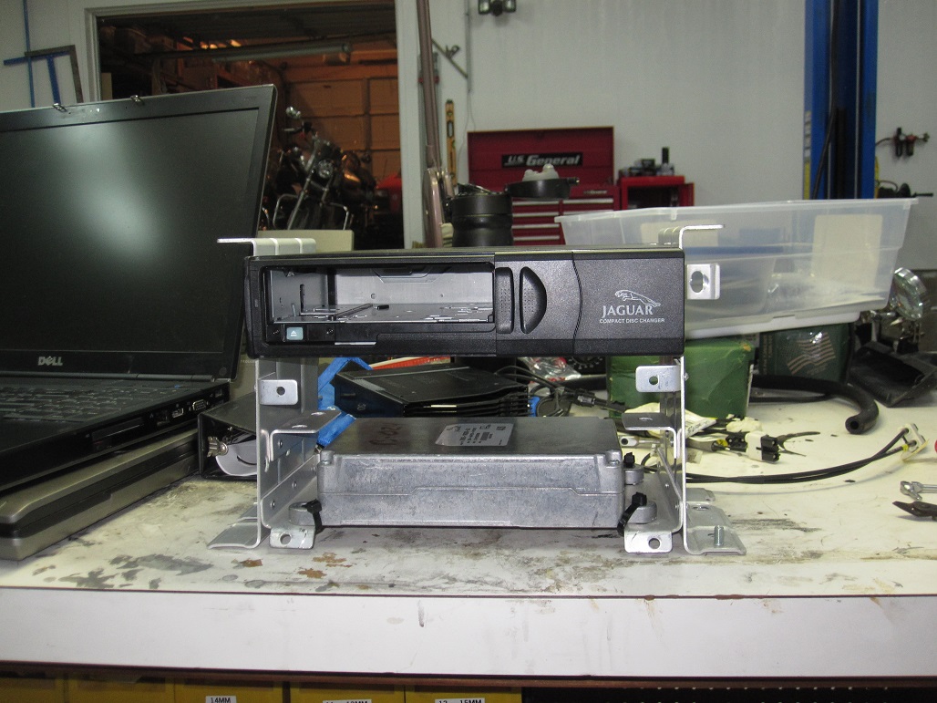

The symptoms were: "CDC Error" in the audio display and cartridge not being able to be ejected.
After doing the requisite research, I removed the compact disc changer from the boot, disassembled it, managed to get the cartridge out, did some lubing where I thought lubing was needed. I did not see any thing wrong with the unit (compared to posts outlining troubled areas) so I assembled the unit back, re-installed it and got the same error.
Figuring it was a bad unit, I sourced one from eBay and the seller guaranteed it to be a fully functional unit. I installed it today and what do you know! The same, exact freaking error: "CDC Error" and the cartridge is stuck.
I pulled out my AutoEnginuity setup and pulled the codes. For the Audio subsystem I got B2477 and B2403.
I am suspecting one of two possibilities:
- Some reprogramming of the audio subsystem is needed *or*
- I was sold a bad unit.
Any experience with this type of problem out there?

The most common fault with these units is the DVD sticks in.
People have removed it manually careful use of a blade while pressing eject.

While I'm surprised that the Alpine changer is not the source of frustration, B2403 points to the Front Entertainment Control Module. Sorry.
The changers are notorious for failure of the loading variety. There is a procedure out here somewhere that is used to fix that, but it appears a "No Discs" on the display.
Again, sorry.
