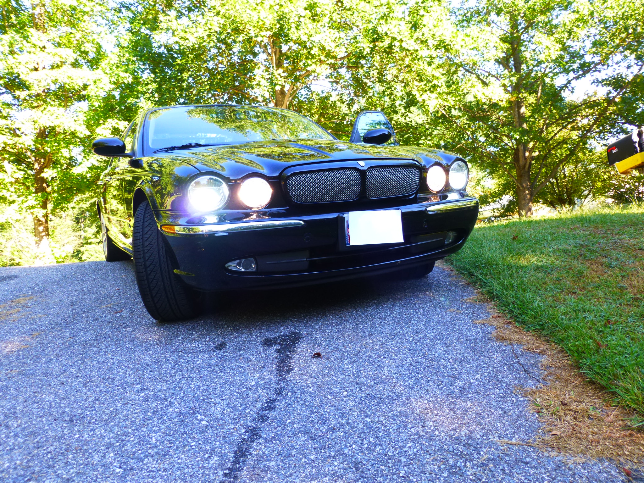

I do not know what I was thinking of in my earlier post!
Attached Thumbnails xj8 main beam doesn't glow when dip beams on-2015-08-22-08.25.06.jpg
Old Nov 13, 2017 | 01:59 PM
Partick the Cat's Avatar
Joined: Apr 2013
Posts: 1,055
Likes: 307
From: Gloucestershire, England
Ooh, where can I get one of those big square lights you have in the middle ?
Old Nov 13, 2017 | 06:32 PM
jackra_1's Avatar
Joined: Aug 2014
Posts: 6,264
Likes: 1,764
Actually some trucks have them over here mounted just above the number plate. Only just started to see them.
