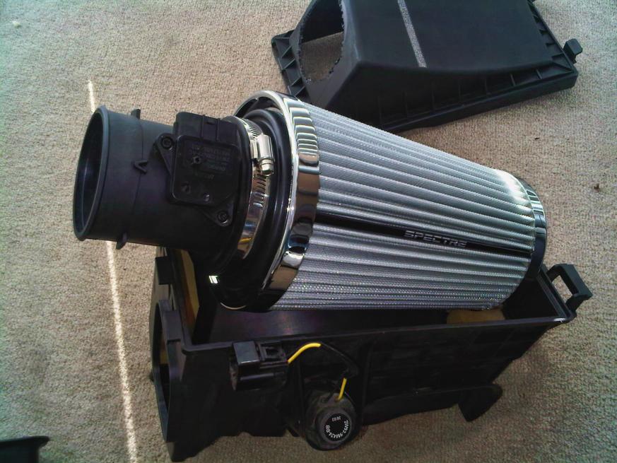

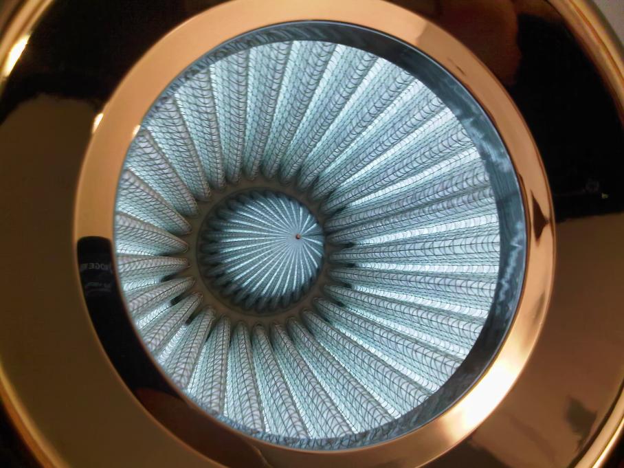

I separated the MAF sensor from the airbox lid so that it could be mounted to the filter. The jumbo filter is made by Spectre, P/N 9738. It's a beauty. I plan on putting a polyurethane foam pre-filter over it because I don't trust cotton gauze filters on their own to provide adequate dirt removal (do a web search on the topic).
I found it easiest to cut the MAF from the lid by using a small diameter drill bit and making a zillion holes around it. I left enough of the original bell mouth (i.e., the tapered opening to the airbox) so that the airflow regime into the MAF should not be much different from stock.
More pics to follow after I make the heat shield and install everything. One more thing... I blocked off the opening to the dead-end noise cancellation tube on the inlet snorkel. AFAIK it is supposed to cancel some of the "offensive" engine sounds. One possibility that I thought of afterwards is that perhaps this particular snorkel is supposed to *enhance* desirable sounds. Whatever.

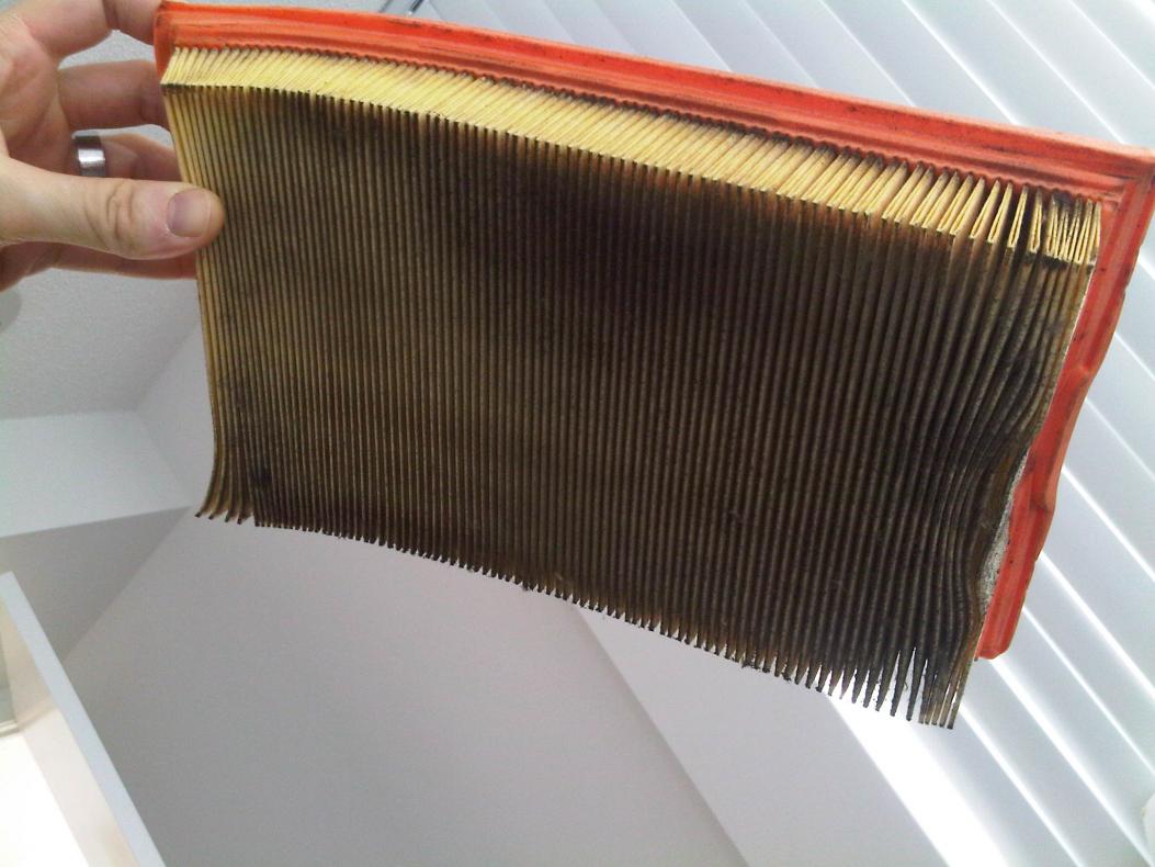

Part of me likes to tinker. Okay, all of me likes to tinker. I also want to be able to hear the (hopefully) nice sounding noises from the intake. More horsepower would be nice too. Besides, the paper filter I had looked like it dated back to G. W. Bush's first term in office; it was full of dirt and dark (see attached).
I really don't expect to get any CELs -- the XJR intake is pretty much the same as that in 90% of the cars on the road.

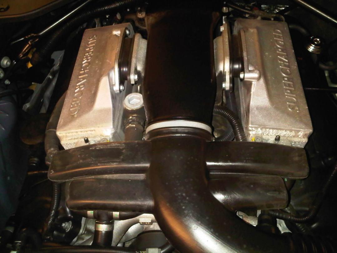

I took off the engine cover and saw four more silencers!!! That's six in total! It's practically a project in itself to block these off! I'll have to think of a cost-effective method to do this.

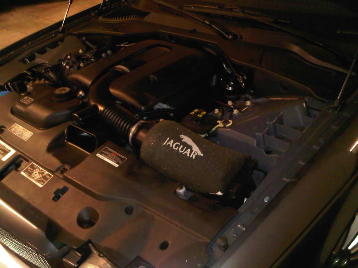

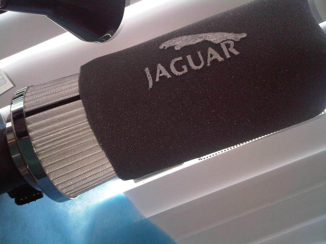

I made a open cel foam pre-filter for my cone filter. It has similar porosity and thickness to the widely available K&N pre-cleaner filters. I added some ghetto-fabulous decoration as well! The embossing is with silicone so it should last forever.
I just mounted the filter in the car and <gasp!> the hood/bonnet wouldn't close completely! Fortunately, I shifted the filter a quarter inch and everything was fine.

Hahaha that factory intake tract is something else. I was blown away by how many silencers there are on that thing when I removed it to install my supercharger pulley!
