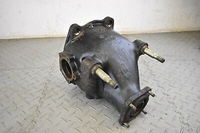

Picked up a 3.58 with Power-Lok but one of the four studs that mount to the IRS assembly behind the driveshaft attachment flange is missing. Would a UNF (almost all the diff stuff is imperial if I remember right) thread bolt could be a good substitute?

I used to remember the thread pitch on all the XJ40 and X300 diffs
I THINK it is M10x 1.25mm but check it to be sure.
The XJ40 used BOLTS and the X300 used studs if I remember correctly.
Either bolts or studs will work fine.

I'm pretty sure it will be a metric thread. Nearly all the fasteners on an X300 are metric, off the top of my head I can't think of any inch sized ones.

Almost 99.99% certain the UJ to stub axle connection nuts are 11/16 matched to whatever UNF thread that is. That’s why I thought the mounting studs behind the driveshaft flange would be imperial too.
They are. I mangled them quite badly with using metric tooling and not paying anykind of attention while changing the diff.

I measured the spare differential I have and those threads are M10x1.5.
