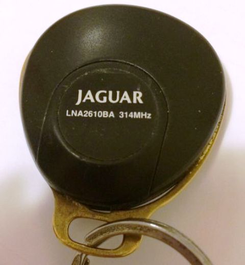

Default 314MHz?
My 1995 XJR 4.0 is a Hong Kong model (same as UK?) and the original Jaguar key fob carries a label that says "Jaguar LNA2610BA 314MHz". Never came across 314MHz in the web search (except 433 and 315). Even offers in eBay UK say 433MHz. I recently replaced the batteries inside and the red and green lights flash OK during testing, but they fade with more attempts, and do not open the door. Has anyone tried after-market replacement? Saab I heard plays the trick (some even claim Ford remote key is good) but the uncommon 314MHz specs on the original key fob boggles me.

That is odd. Governments generally decide which frequencies are allowed for radio communication, so it's maybe something that the Hong Kong government mandated? Does seem strange though. I noticed in the parts list that is gave a part number of LNA2670CA for Hong Kong, maybe that is the superseded number? It doesn't say what the frequency is but does say that the transmitter is required to have a special type approval label on the back. I'm wondering if it was just a silly spelling mistake? Wouldn't be the first for Jag
The Saab remotes from the 94-98 900 series do work with the MY95 cars that have 315MHz systems, I use one myself. Might be worth picking up a used one on Ebay, part number LTQFM433 ($20-30) and having try?

I double-checked and there was no mistake - here is a picture of the key fob label.
If 433 MHz it is then there are many available on ebay.

Parts found in Jaguar Classic Parts UK; priced at GBP24 new
Part no. LNA2610BA | Transmitter parts from Jaguar Classic Parts UK

Amazing that they only want 24 quid for the 314Mhz transmitter and 129 quid for a 315Mhz version!!!! Highway robbery is alive and well!!
Japan and Hong Kong require 'low power' remotes by mandate. You can't unlock your car from 100ft away like you can most other places. Don't know if that should justify the price difference, though. That is also probably why the 314MHz frequency is foreign to most folks.

I have ordered the 314MHz transmitter and will see if it works. My other original two are dying.
