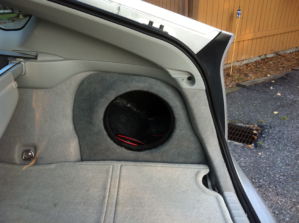

I make a subwoofer enclosure for a Gen 3 Prius (my daily driver), I'm guessing something similar for my Jaguar would be nice in the boot.
Depending on what kind of a demand the thing would bring, I'd make a mold of it and make them available in the US for a fair price. I thought about a wooden/MDF box, but they use so much room.
Attached Thumbnails 6x9? rear deck subwoofer-right56.jpg   6x9? rear deck subwoofer-right57.jpg   6x9? rear deck subwoofer-right60.jpg

I did use "boot". It's a British car, right? My MGB has a boot, bonnet, and hood.
I'll have to drop a boxed sub in the trunk some time to see how it works. If it bombs, then thanks for the head up. Maybe we could port it into the back seat. hmmmm
