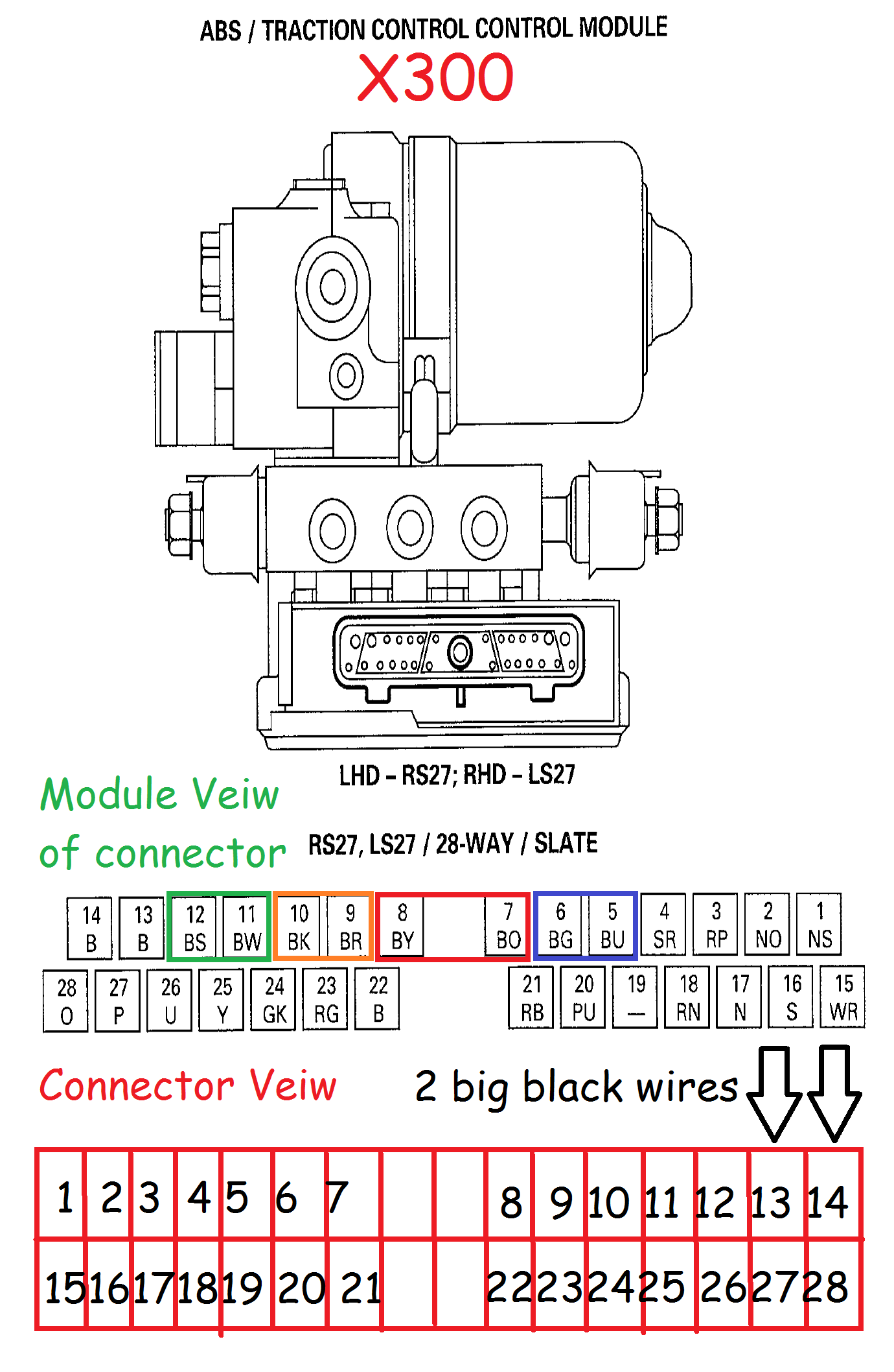

Dude , you can read the sensors before you clean them and if there is any problems in removing them and if there is a open one then it is obviously bad before you remove them .1300 ohms but it doesn't mean one is good .If you want to put a meter on them before you possibly break one to see if one is out of range ( 1300 ohms if I remember ) you can unbolt the module connector and read socket pairs 5-6 LF 7-8 RF 9-10 LR 11-12 RR but the generated signal it makes is pulsed shape you can't see without spinning .
Attached Thumbnails ABS/TRAC lights on-jaguar-x300-abs-untitled.png
