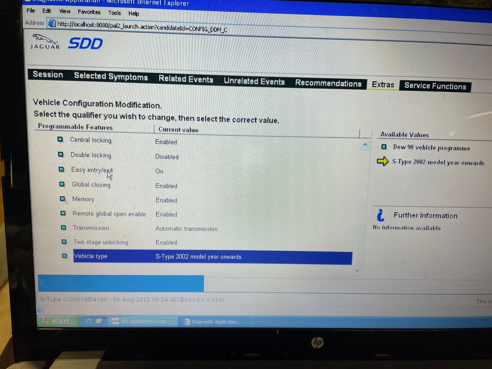

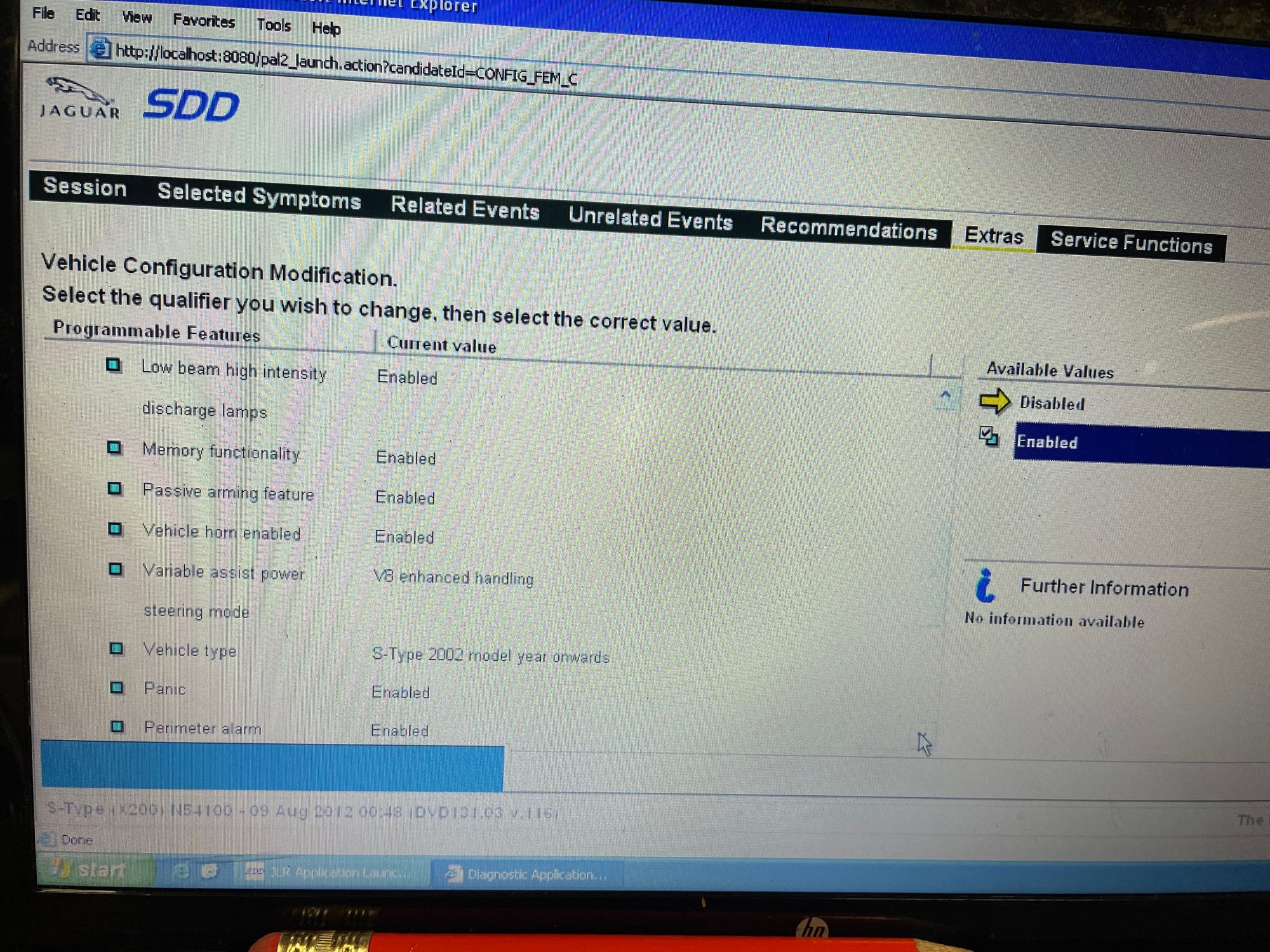

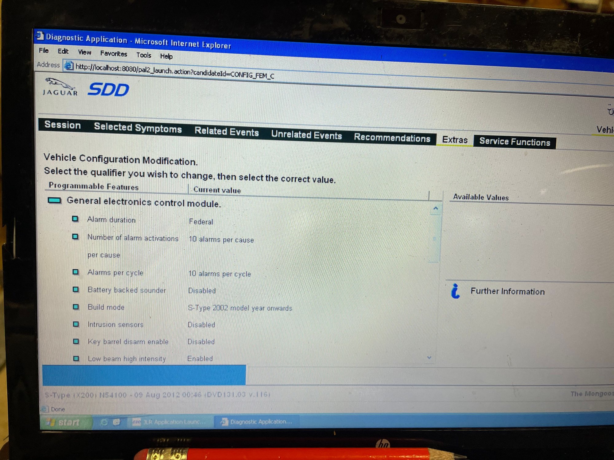

just done a little research and saw that the tilt sensor is JLM20344 and was a factory option that was the same on later model xk8s as well as i assume others. And should be plug in, and then turn on via the dealer level software.
