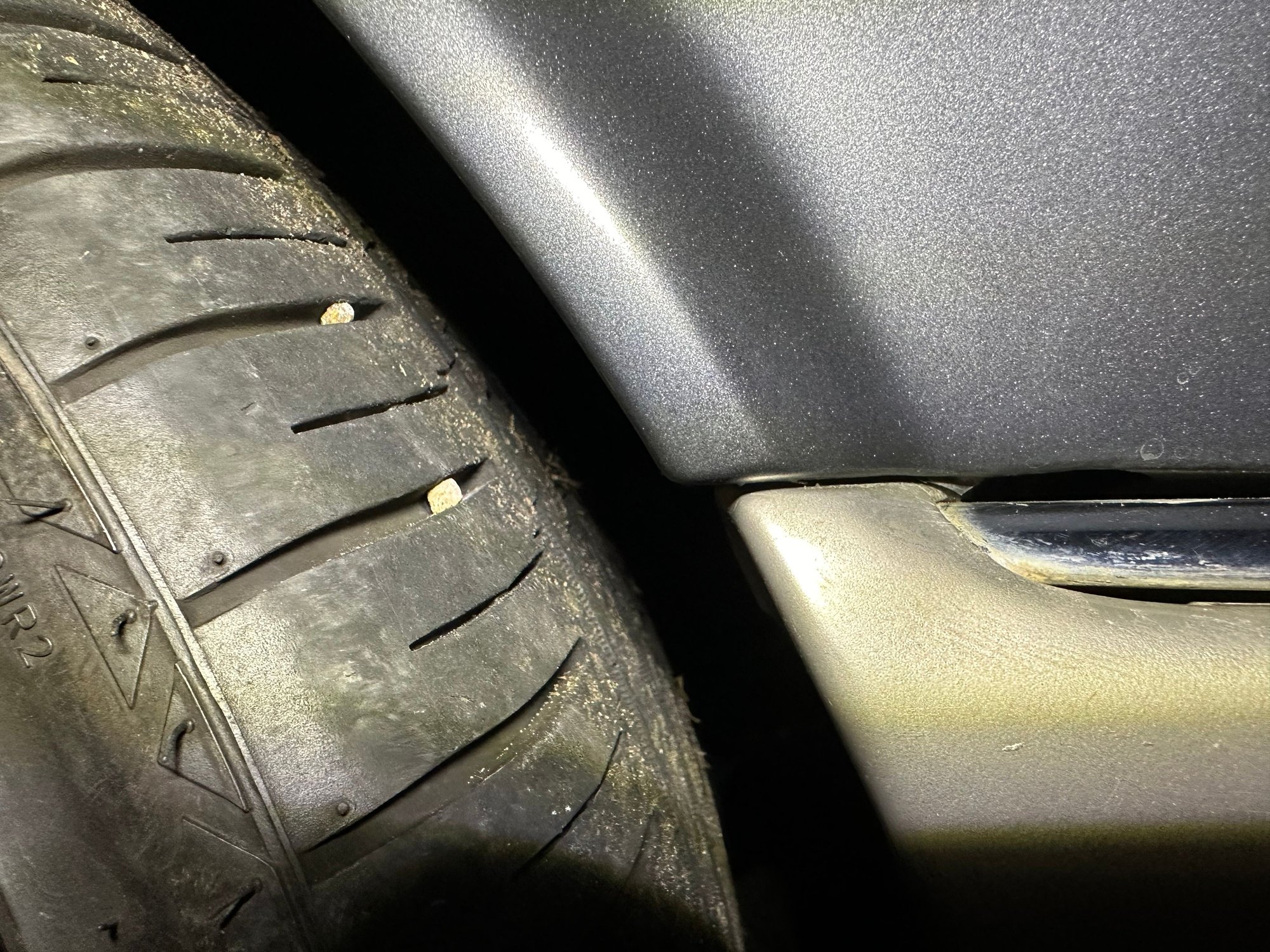

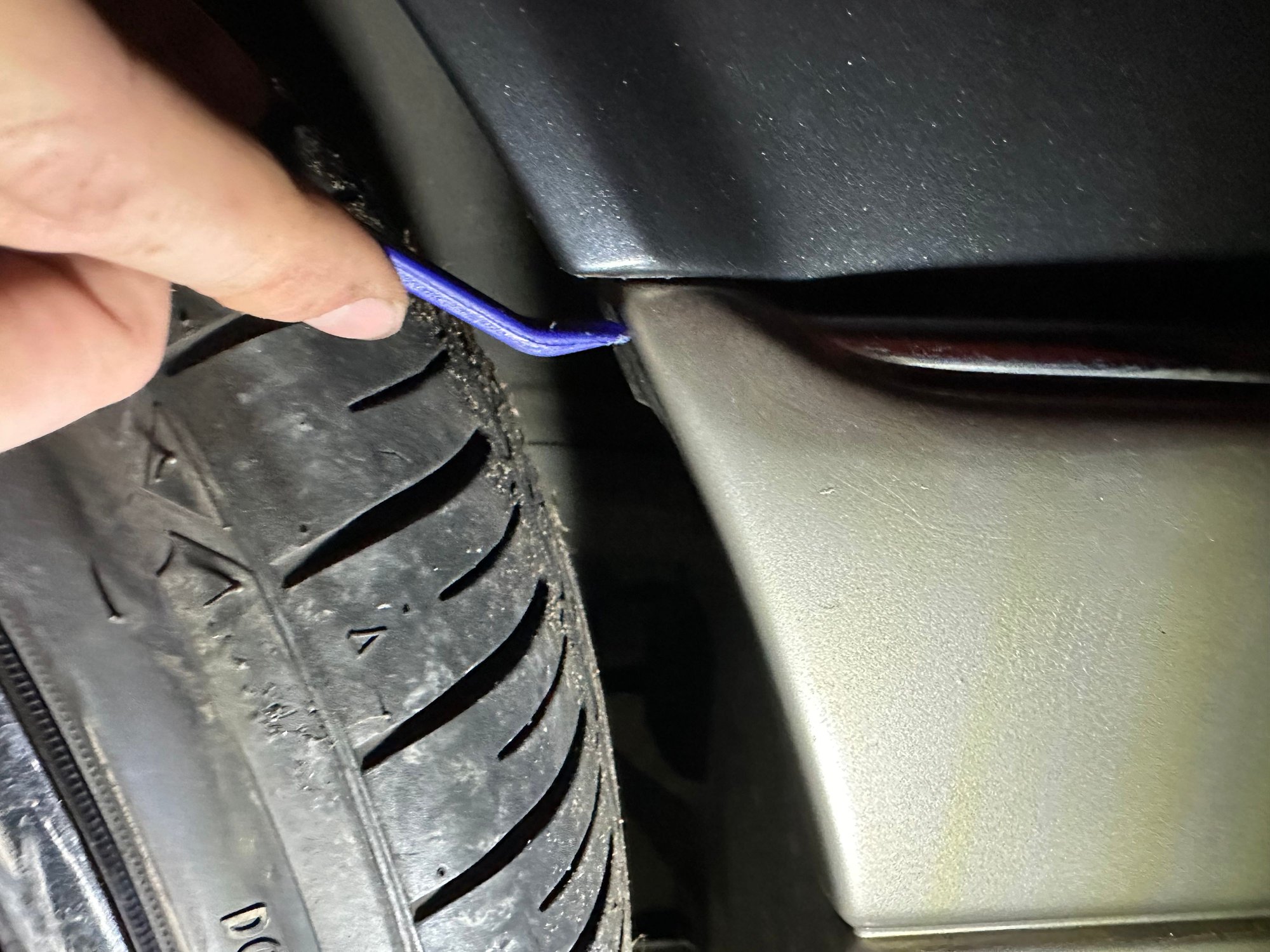

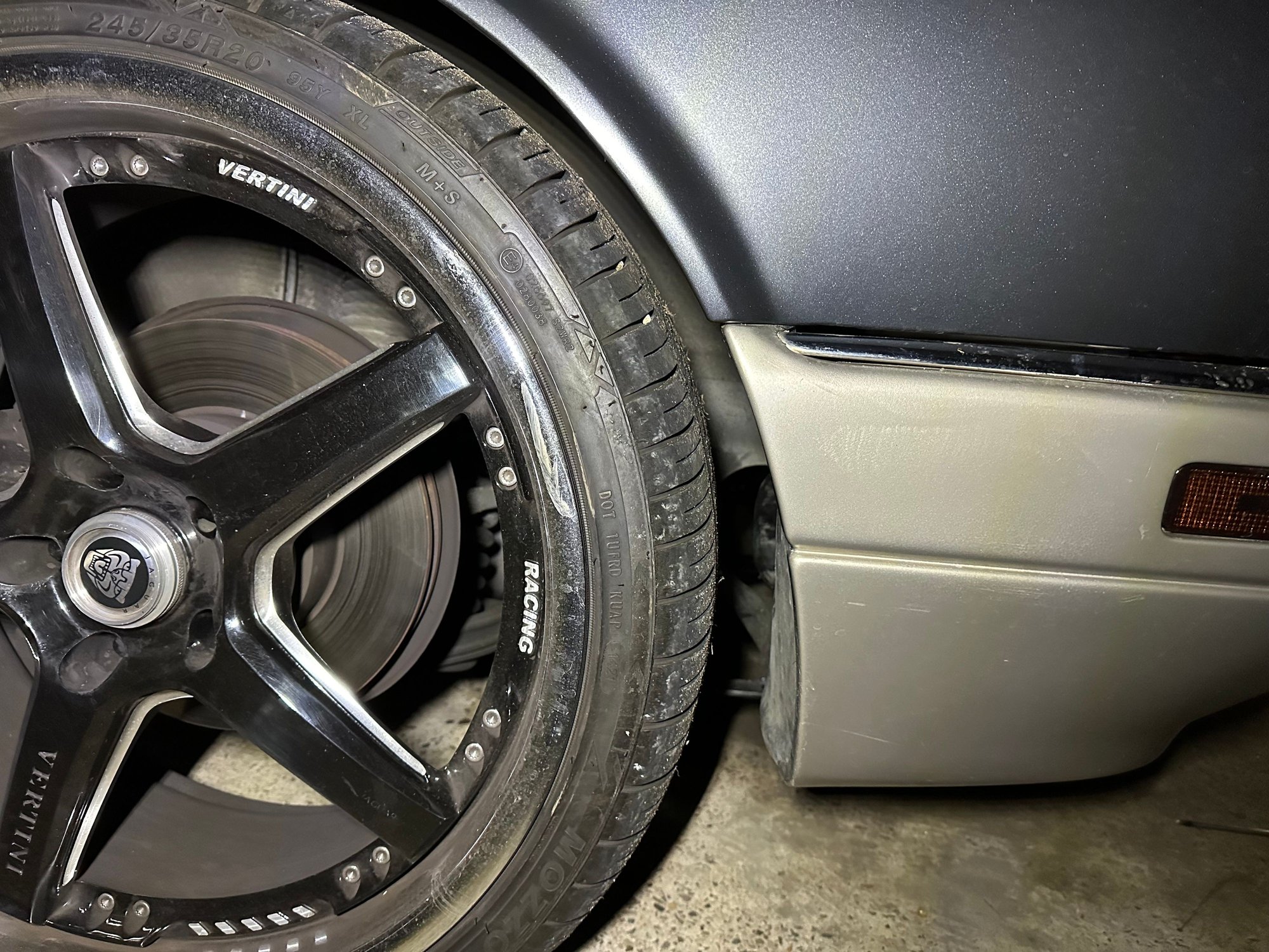

So i played around and can see how to adjust the height of the bumper by adjusting the slide mount on the car and the threaded part of the mount.
but where i am a little unhappy with the alignment is how it its in relation to the guard.
now if i loosen the bolt on the mount there is not enough play to push it back any further.
is there an adjustment somewhere?
or is there really not much adjustment in this regard?
cus if i take the bolt out of the mount and try to allign it better i then can not get the bolt in the mount.

I could pull the guard forward,
but then that creates the whole thing of increasing the gap between guard and door and guard sitting further forward than the bonnet.
