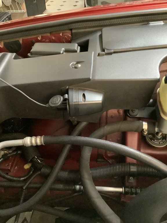

I have attached photo of my solution to a trickle charge point under the bonnet.
The power socket has the positive attached to the large positive terminal adjacent and powering the RH fuse box and a suitable earth connection to the body.
I have had this in place for many years and it is excellent if your vehicle sees limited use and occasionally just requires a battery top up ( trickle charge )
The power socket also provides easy 12V access under the bonnet.

absolutely love that idea.
i might have to steal that one for myself.

Thanks John. I agree with Spud that your socket installation looks handy as it allows charging without having to move stuff from the trunk to access the battery. However, I do have at the back of my mind having seen a comment somewhere that accessing the power source via the fuse box poses some risk of adverse effects. Can't remember where I saw that but I thought I would mention it. Obviously you have not experienced any such effects.
