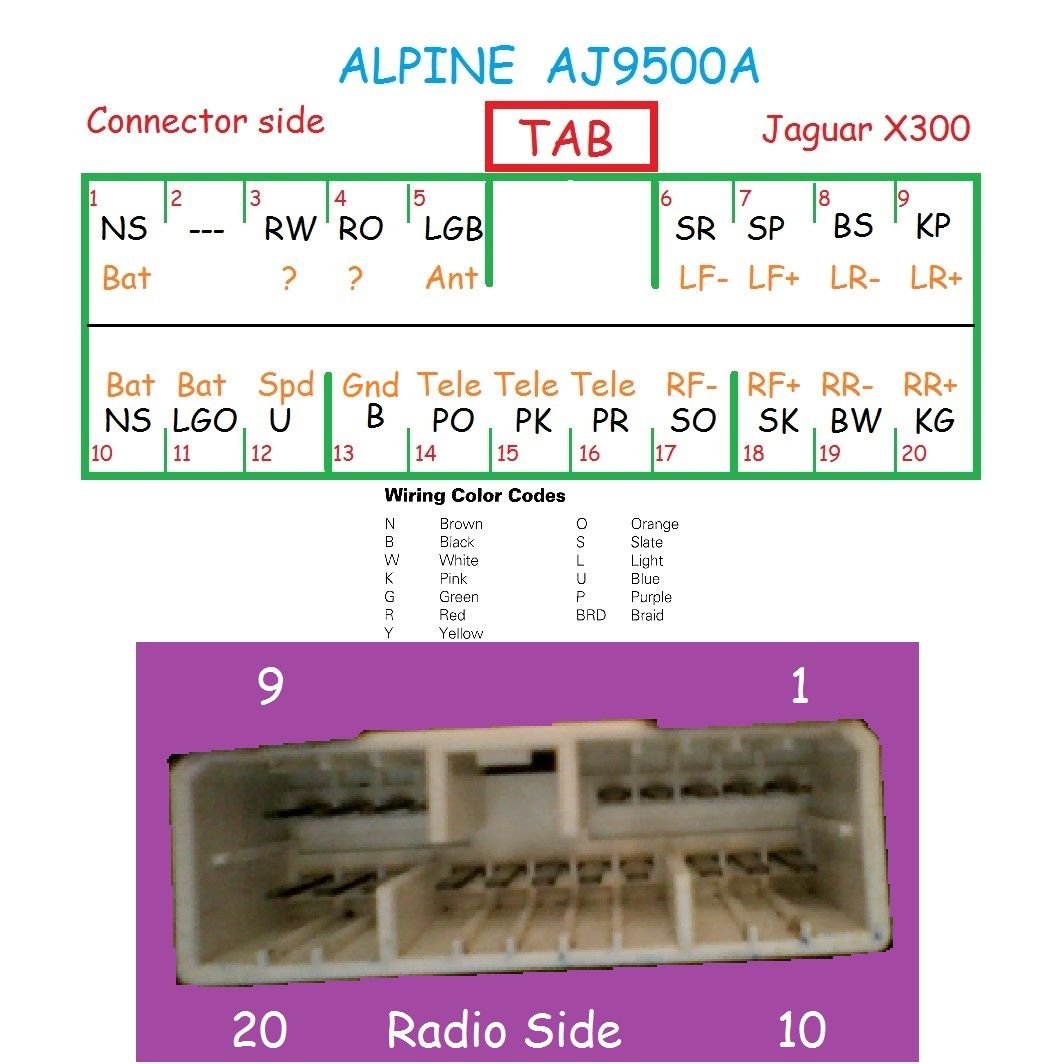

The other mod is tapping into the cassette circuit with a jack soldered into the cassette head pickup , this will be your free input line this is direct with no signal loss or compromise but losing the cassette . This is no cassette device insert but you place a tie wrap on cassete carriage inside to mimic the cassete needs to be alive
Marks device will plug into the 8 pin DIN plug at the original head and if you have the external in the trunk final stage amplifier ( premium Jaguar stereo option ) you would loss that and would have to use the original built speaker outputs coming out of the rear AJ9500A
