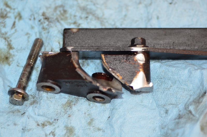

Well it could be really bad news, this was my upper chain ramp upon removal.

Old Mar 30, 2014 | 03:52 PM
Juliesjag69's Avatar
Joined: Oct 2013
Posts: 50
Likes: 5
From: Cambridge
Engine strip down then?

No, timing cover removal. Do you have an XJ or an XJR? I ask because the procedures differ a bit.

You can follow this guide then.
Jaguar XJ6 timing chain, Jaguar chain guides, repair, overhaul
No big deal on the on the XJ.

Yes, you need 24 hours for the sealant to cure. So I do the tear down on day one then refit the sealed cover (replacing whatever timing bits needs to be replaced) then on the next day I button everything up.
Sadly I've done this twice now since I didn't do a good enough job sealing the cover the first time. Use LOTS of sealant. This time I used a high tack sealant and it appears to be working. The first time I used the actual Jaguar sealant and was not impressed.
