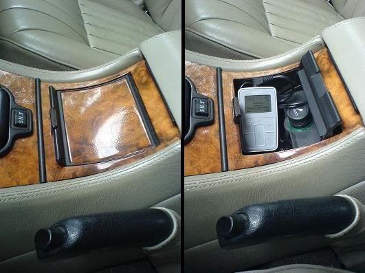

I bought, via ebay, a harness that i plugged into the factory unit in bothmy XJ40 and X300. Whenever I press "cd" the stereo sources music from my mp3-player. Sound is superb and I really like the standard-looks of the Jaguar radio unit. This is how it looks in the forty;
[IMG]local://upfiles/3471/B70C4BEA9CDF43F0BFDAAD8D0F9D4751.jpg[/IMG]
I know this is pretty old now, but I'm wondering what kind of adapter that was. I want to do exactly what you did there. The cassette player on the stock radio is worn out now.
