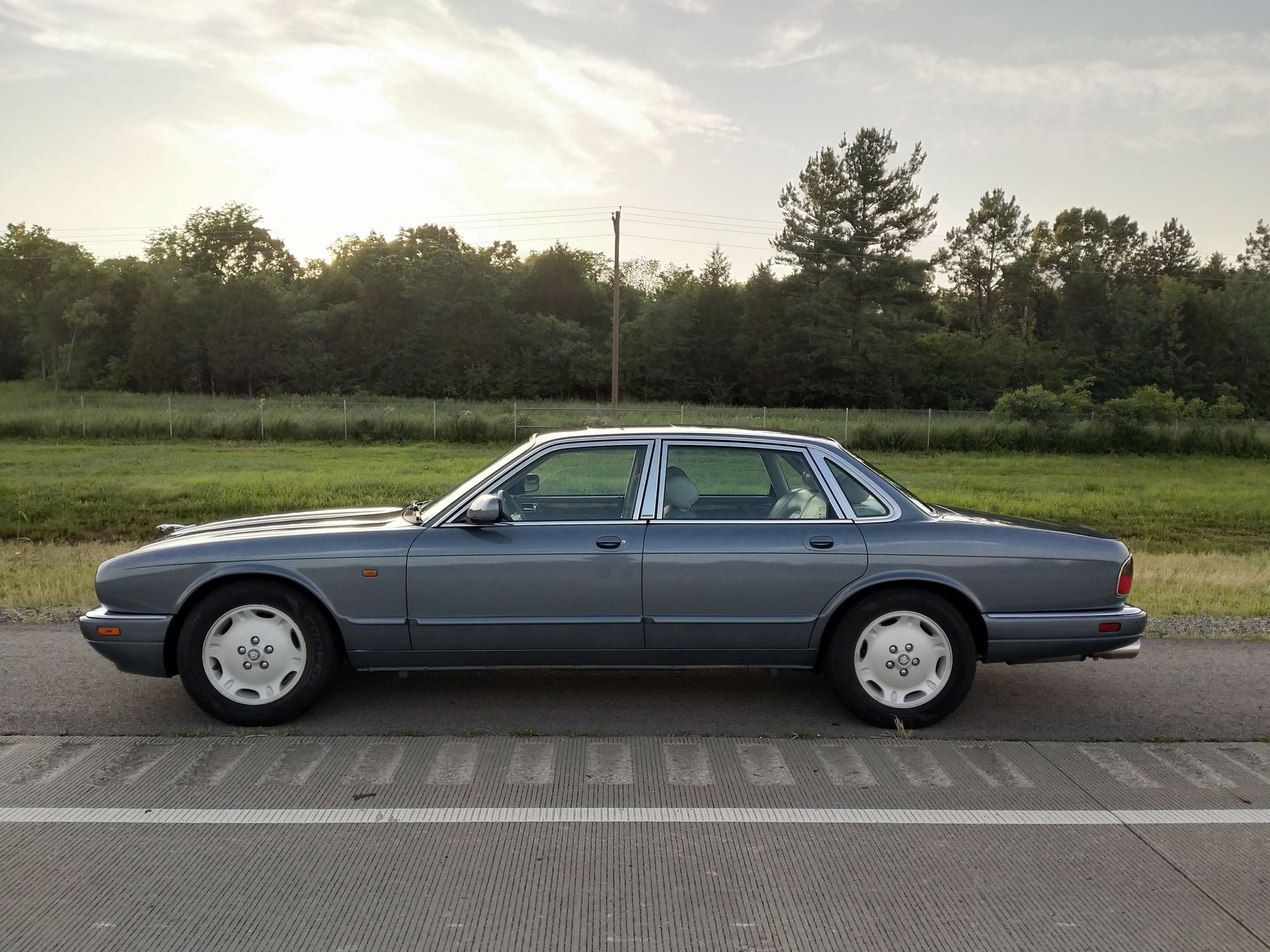

I have ran into another issue with my beautiful x300. Few days after getting it repainted to it's original color (titanium metal) and a day of photoshoots (will come soon), I decided to take a newly built hwy that is never in use. I put the metal to the petal and shortly after reaching 70-80 mph, I felt a sudden loss of power. I pulled over quickly and shortly after the Jag stalled. I opened the hood and saw white smoke coming from the upper cats. I ran my Bluetooth ecu reader and got the following codes, random misfire, cat damage bank 1 and bank 2. I suspected a clogged catalytic converter.

I'm sorry your engine is malfunctioning, but your new paint looks great!

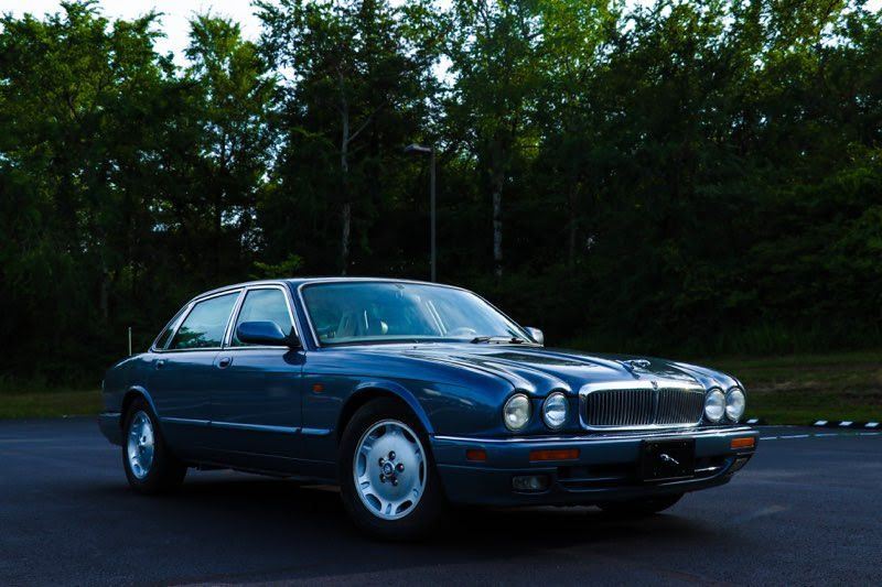

Thank you very much! She definitely transformed after that, clear coat was almost gone with the exception of a few patches on the hood, cracked paint, and a few dents. Only $1200!
and not a stock photo lol

Nice paint job by the way!
