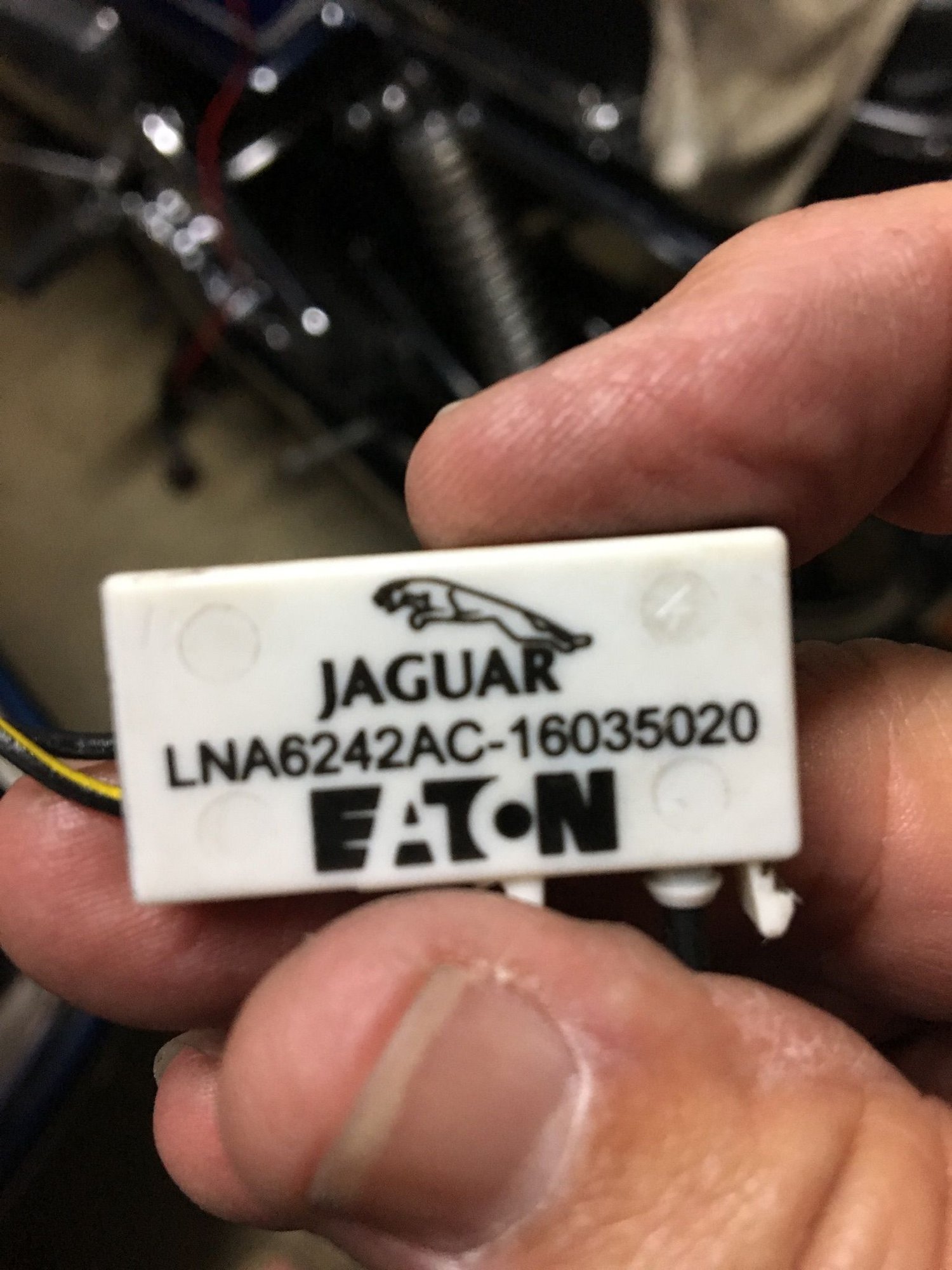

Does your boot/trunk lock and unlock normally using your remote fob? Sometimes the micro in the latch can break and the car locking system is affected. Does the boot/trunk open light ever go out?
This micro switch can be replaced. Pic attached.

There is also a micro in the door latch which can malfunction but you would have to get one out of another door latch, or replace the whole latch, as I don't think the switch is available as a separate part. It is a bit tricky to change this micro as it is wired into a single plug with the other wires.
