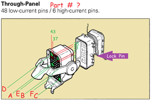

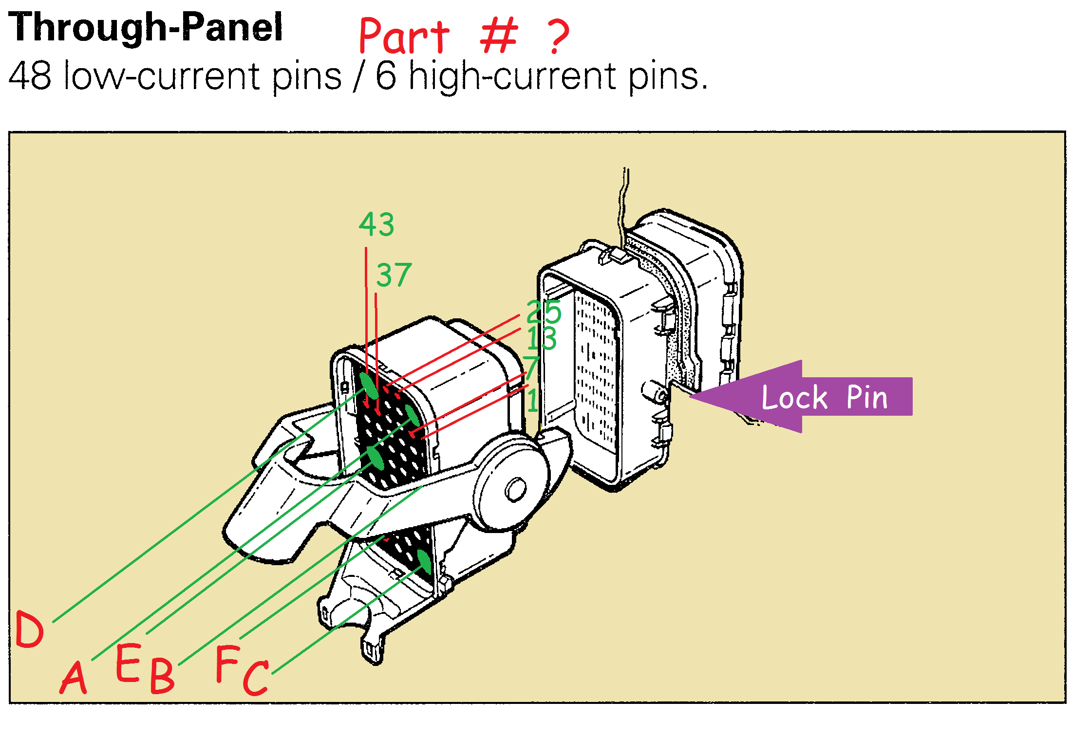

You can read it at the RS3 connector pin 25 to ground . There is a resistance value for a empty tank . There is a fuel level sender cleaner other them the injector cleaners and others . There is a organic growth that forms on the potentiometer

With a meter . Something like 180 ohms empty if I remember
