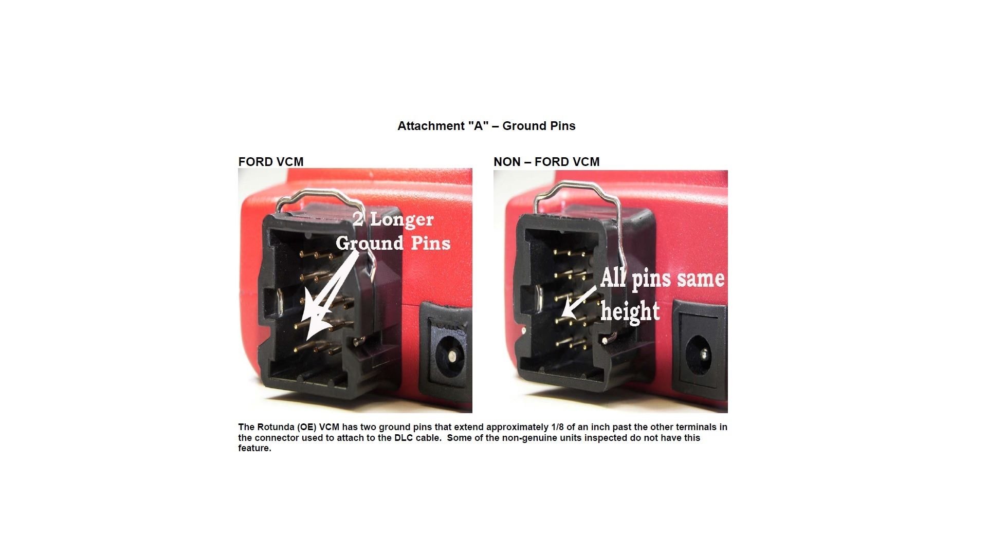

Originally Posted by WDS newbie
Hello Jagsandmgs
Here are some images that I received to help verify if the VCM is genuine of a clone...
Sorry, that's not how I intended to put it up.
Here is a picture of the pins on a genuine VCM...

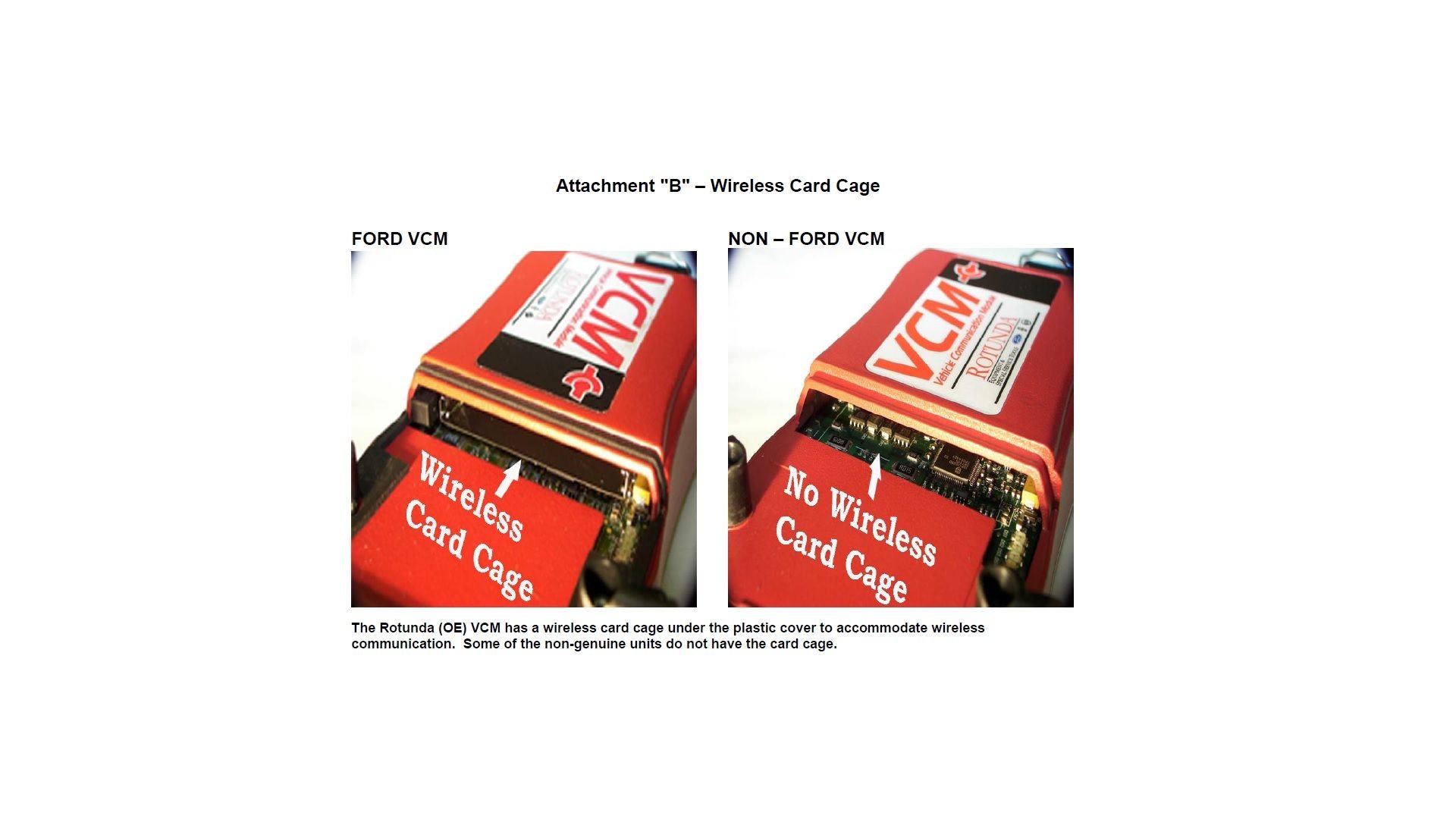

Originally Posted by Jagsandmgs
Well to say I’m happy is and understatement. I bought the auction and figured if it’s fake I’ll make a claim with eBay ... but it’s real. Aluminum case, all gold inside.
Now I just need to lean on Motorcarman for some software... and either run on my existing XP VM or get an old laptop...
i already have a PDU up and running too. Anyone in New England that needs work involving these tools, contact me. I work cheap.
Then there is the wireless cage...

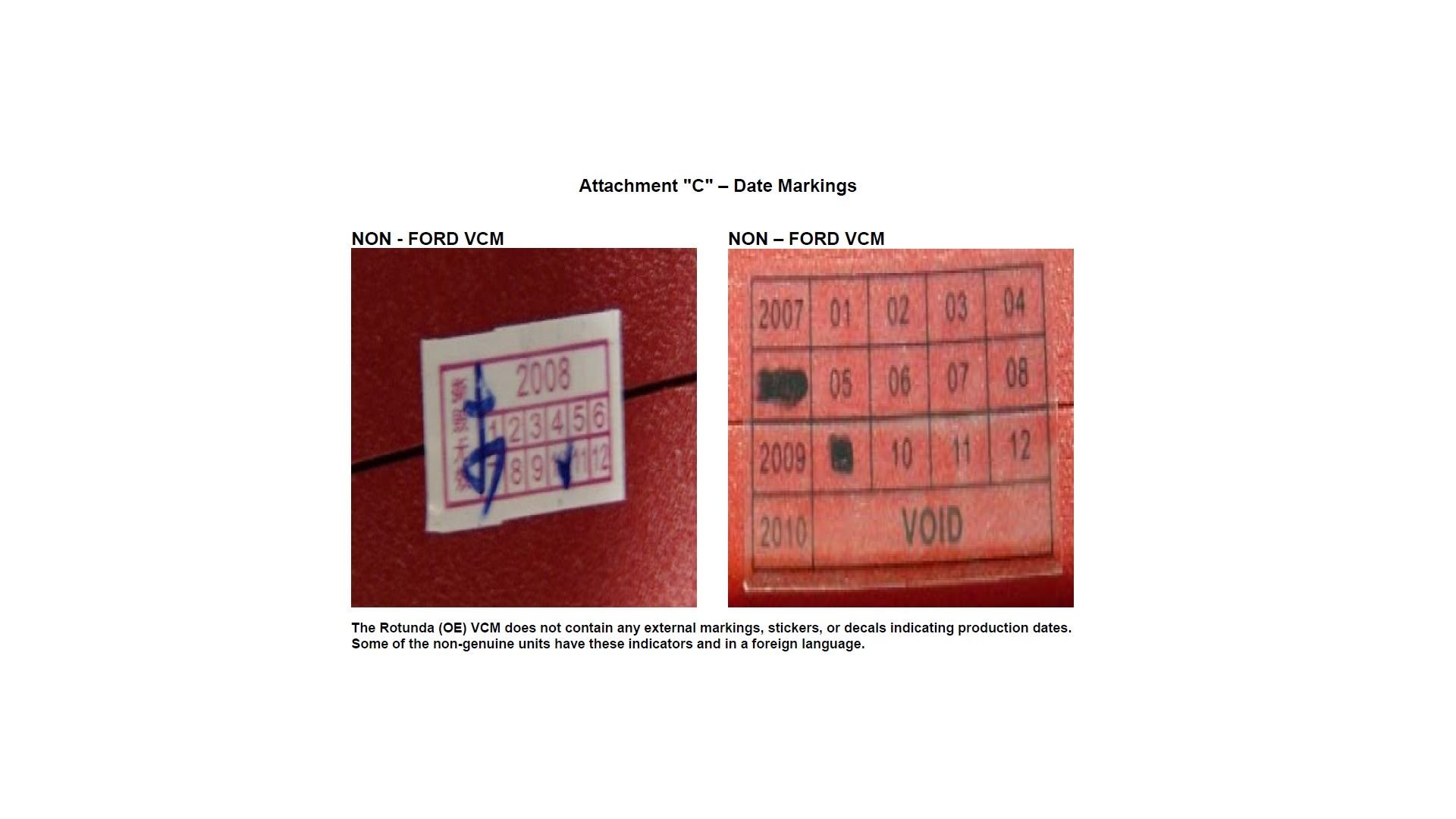

And the last one I received shows the specific logo types and dates, or lack there of...

I have a genuine VCM which works well, I have performed both O2 sensor orientation & TPS setting on my XJR with very satisfactory results.
Yes, I would confirm the two ground pins shown are longer.
Have attached six attachments showing points of difference between genuine & Clone VCM's which still seem plentiful.
