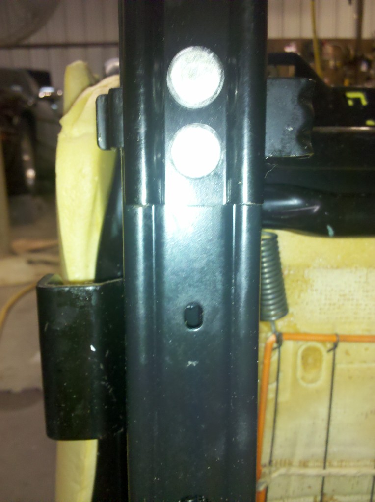

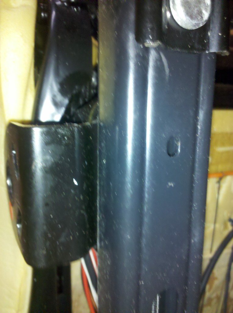

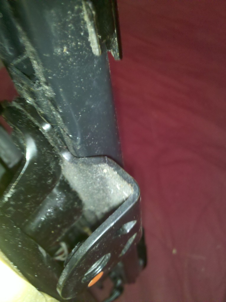

OK OK ..so I got curious and went out to have a look. Again, it's the LH seat from LHD, but I would imagine they are similar. And if so, No, ya can't. It is fixed to the traveling part of the frame and there are rivets involved. Not sure why you want to get the bracket off, though, you can just unbolt the belt from the bracket:

Thanks aholbro1, I think you've answered my question. Great pics too, thank you. I only wanted to remove the bracket if it was able to be detached without removing the seat from the car, and then I would detach the belt from the bracket. With everything in place I couldn't tell if the bracket is fixed to the frame only by the torx bolts or not, but obviously it's not as you say. So it looks like a seat-out job. Did you have any issues removing the seat?

Yeah I steered you wrong - it's a hex not a torx. I'm reasonably sure you can find a seat position that will allow access
