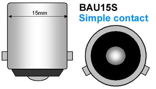

So, regarding the rear bulb assembly in 97 vdp, if someone were to, let's say, put a 'p21w' base bulb in a 'pY21w base' bulb-socket, it can get stuck, you may wonder how I know this.
I found that the pins that hold bulb in place on the ...
  • 'PY21W' are offset to one side (150 degrees) ,
    • so turn signal bulb socket is meant for (150 degree) bulb.
  • 'P21W' pins are straight across from another (180 degrees).
    • it is easy to get that wrong bulb in to that socket
