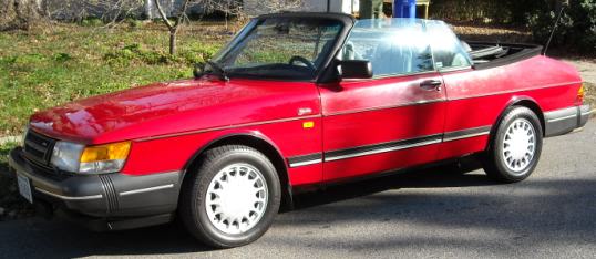

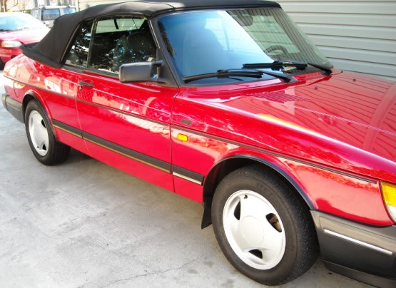

The contract that I'm currently employed on ends at the end of Jul, and unless I get something for sure to start on 1 Aug, I'm making plans on driving one of my cars back to southern California from here in Norfolk, VA. The cheapest quote I got to ship a car from VA to CA was over $1000, so I figured if I'm going to be in-between jobs, I'll save some money and just drive one back, and make a little vacation out of it.
So with that being said, the car I'm planning on taking back is my '91 Saab turbo convertible. That cars runs GREAT right now, with LOTS of work done to it by the previous owner, and some tinkering from yours truly as well (newer Saab rims, front-mount intercooler, new exhaust, etc). I need an extra car back on the west coast, and the convertible is more suited for a So Cal driving environment than here in southeastern VA:
I was having issues with it not starting as well, and when going thru the receipts from the previous owner, he had replaced the battery, alternator, and starter, so it sounds like he was chasing a no-start symptom as well. I searched thru a Saab forum that I belong to, and went so far as to clean and lube the ignition switch in the center console, which didn't solve the problem.
Since I also have a "classic" 1984 Honda Goldwing standard, I decided to get a Battery Tender, and hook up the quick connect to the bike, and use the clip-on connectors on the Saab battery. I left it hooked up to the Saab for a couple of days, got a new digital multimeter, battery was holding over 13 volts after being trickle-charged, and that seemed to fix it, hasn't failed to start since. But, just to be on the safe side, if I know I won't be driving the Saab for a few days, I'll leave it hooked up. But I do "trust" the charging system on the Saab to get me from VA to CA without leaving me stranded.
The Saab has 142K miles, and my XJ6 has 92K, so it would probably be a coin toss as to which car would be a better candidate for a cross-country drive. But I'd like to keep the Jag here with me in VA, and the Saab would be a welcome addition to the stable back in CA. But it's an interesting thread about how our cars "earn" our "trust", especially if we like having cars like Saab or Jaguar in our stable!
