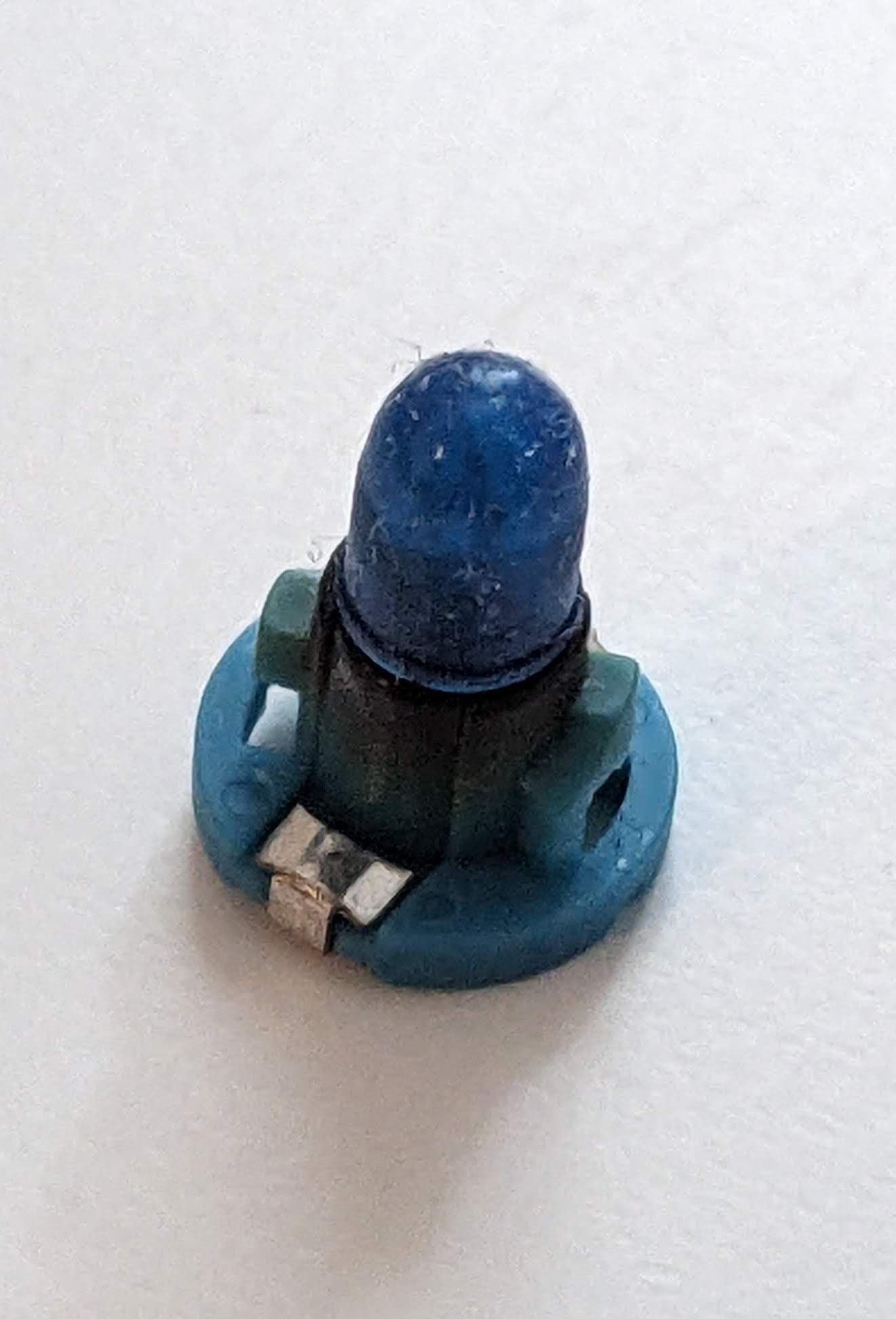

It's 2026.. useful thread and info, has anyone bought neo wedge bulbs for the clock recently? Interested to know what are the best ones to buy.
The original bulbs are capped blue, should I get green or blue?
I've read about the t4 neo wedges being too bright and needing to be turned at an angle but these ones screw 90 degrees into the little circuitboard.
the two clock bulbs are in the center where they scorch the clock ribbon.
I have three clocks, my original one and a couple of wrecking yard editions, one of which has a fascia/ missing buttons too wide for my car but useful for parts, bulbs, screen etc.
i currently have a wrecking yard clock staged in the car
//(along with a 'new' wrecking yard head unit that has a readable screen, functioning cassette deck and will play cds from the trunk/boot changer.The old one played intermittently, this one is stuttering cd play. Still need to find out what's going on, if it's the din plug or at the changer end causing issues but getting there).
// I was looking at
these green ones these green ones
, (or blue), will they work if painted, shielded etc? Presumably they're not going to scorch the new ribbon I have ready to install but might be way too bright?
Also for those who have done this not quite sure what the best solution is with new ribbon? The old clock was very faint and unreadable, the 'staged' junkyard one is brighter but has a 'gray' screen rectangle around it, hard to see if I can actually change the time, which is why I have it 'staged' sitting proud of the fascia to test. I will probably try to repair the original clock, although that one (96 x305 v12 has a slightly mysterious plastic casing enclosure holding the circuit board and ac buttons etc I haven't figured out yet.

I did find this link in the FAQ
https://www.jaguarforums.com/forum/x...dimming-38712/
But interested in any new bulb purchase options.
It appears 'Warm White t3 neo wedge 3000K dimmable' is what is needed in 2026, I ordered some..
