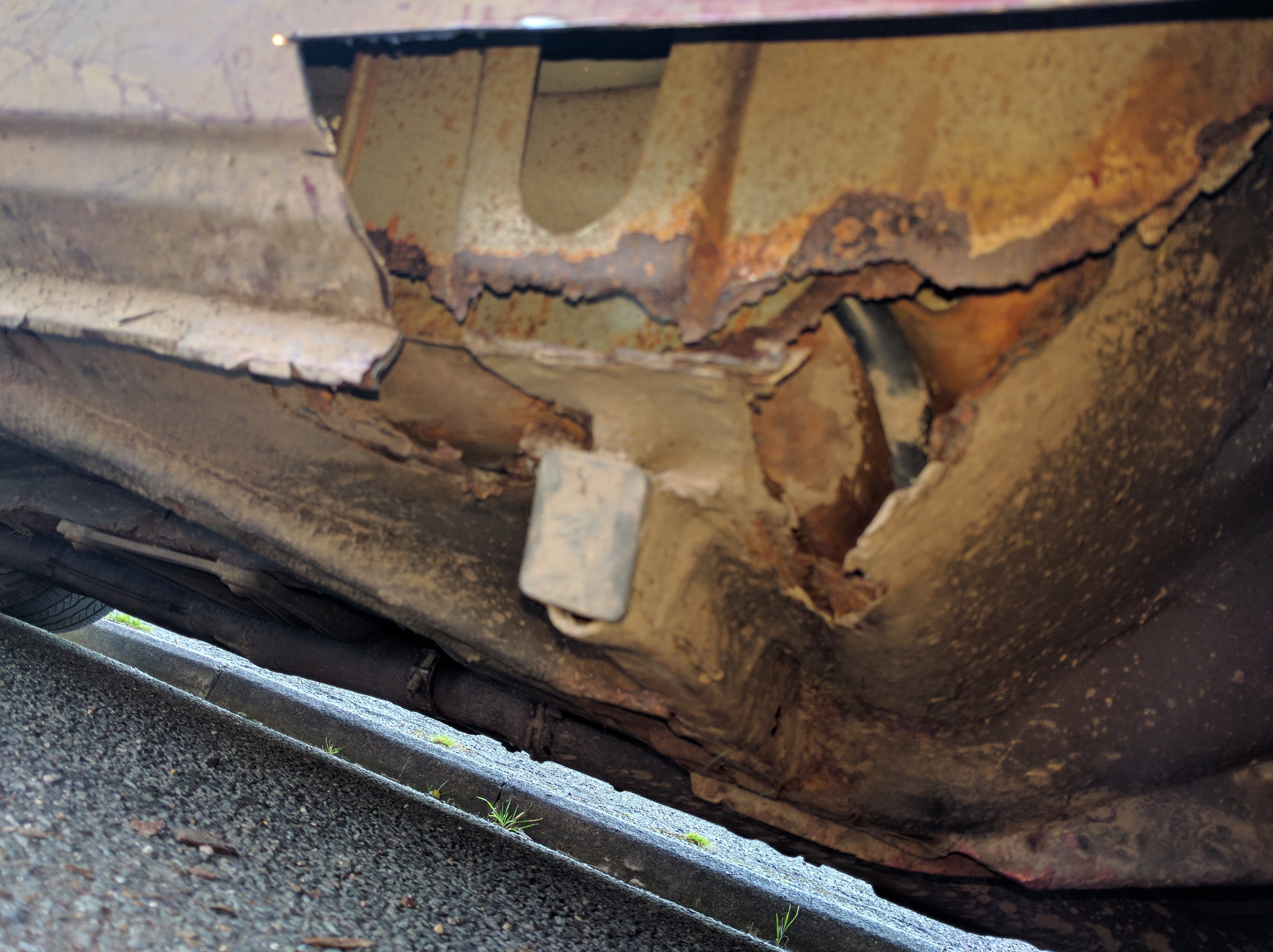

No need to remove the throttle body, although it would be a very good idea to clean it up as its probably the reason it doesn't close properly.
A new spring is Jaguar part NBB3131AB, its visually slightly thicker compared to original spring and its definitely stronger. All that it takes to fit this is to remove the throttle cable and undo three screws from the top, lift the top of the TB where the cable routes, remove old spring, fit the new one in, put the top and three screws back on, fit the cable, job done. Literally a 15 minutes job and the spring cost ~$2 from Jaguar in UK.
As for your project, the idle/misfire issue should probably be the least of your worries.

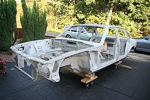

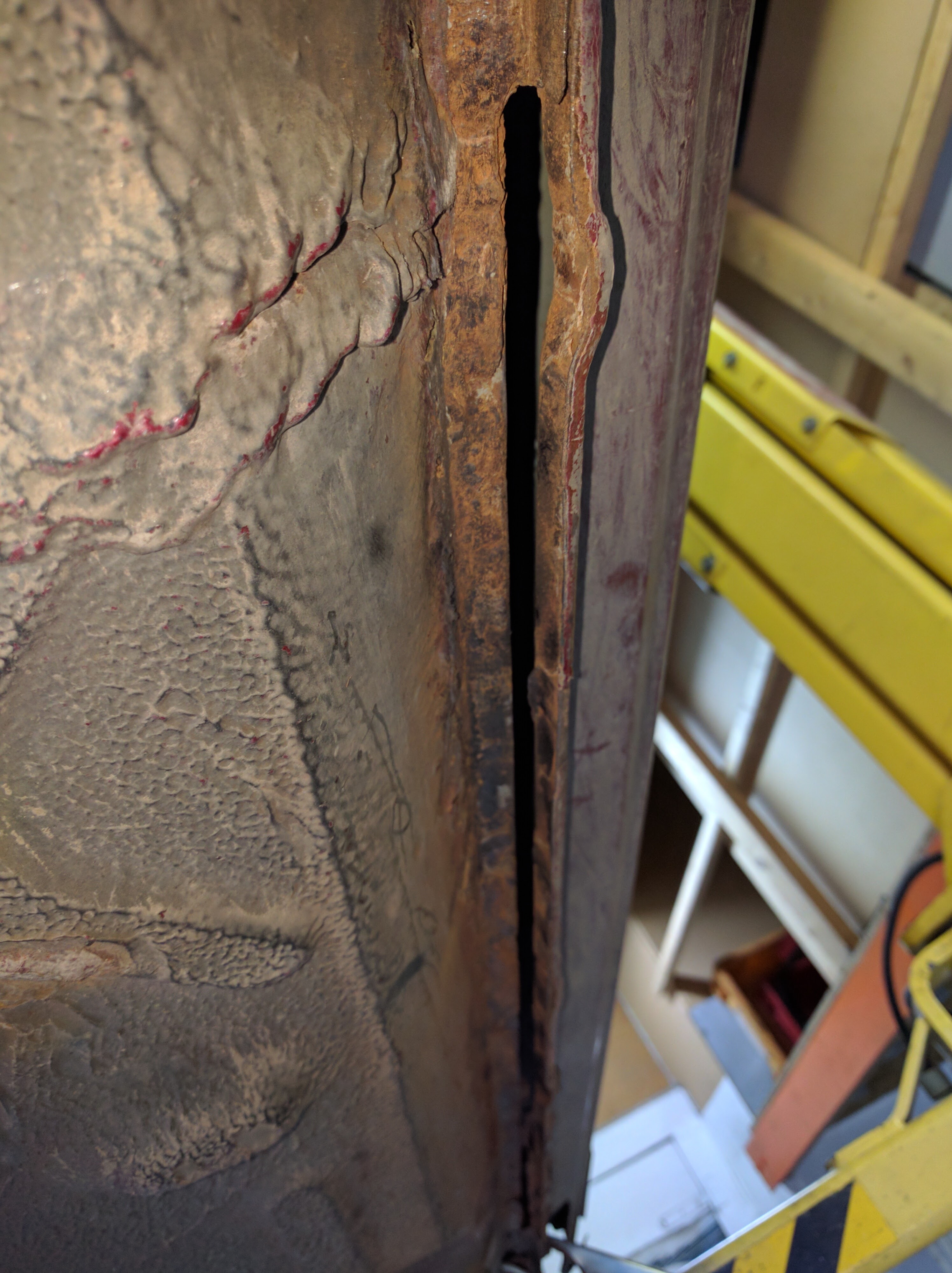

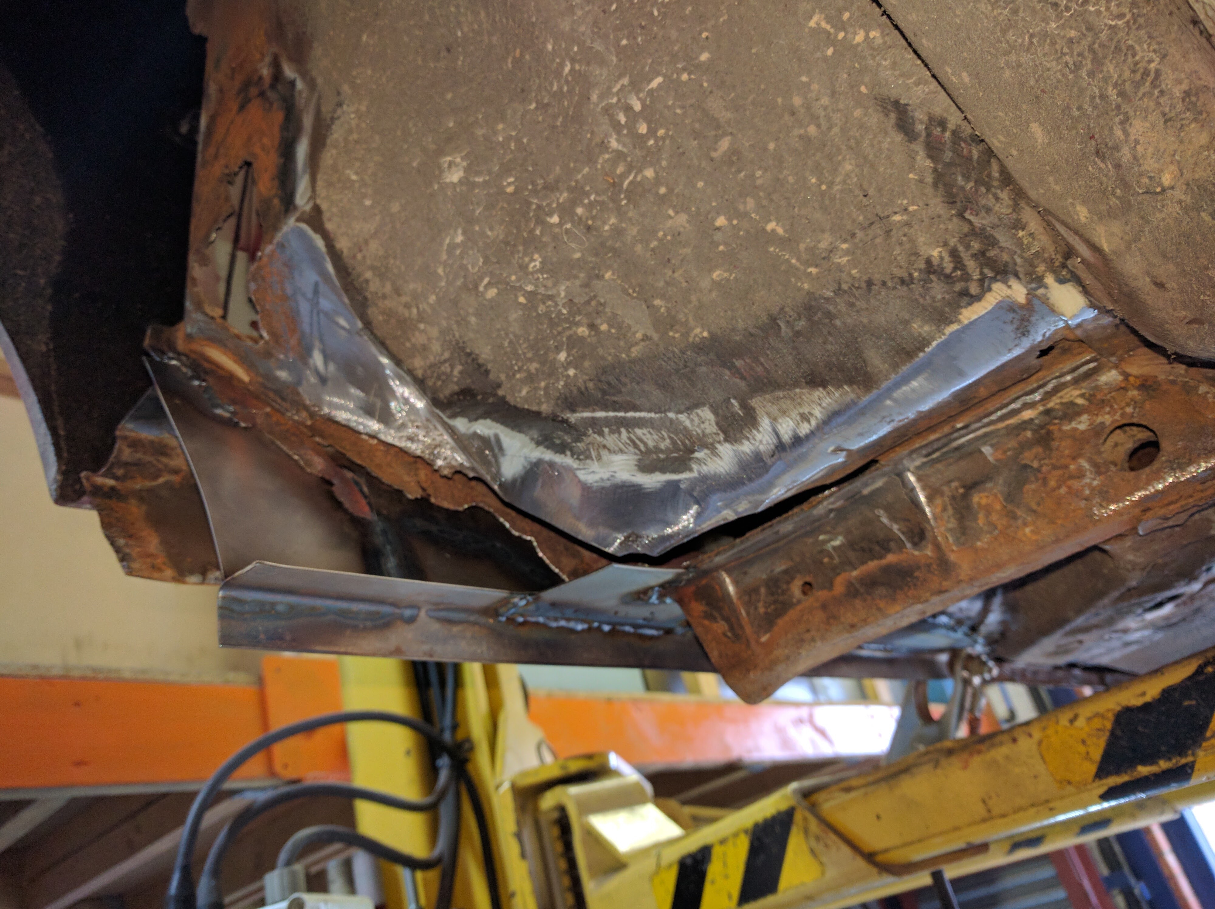

Look for rust as this is always a major issue with these cars, the front floors where they meet the sills and the toeboard is usually worst. If this is gone its going to be very expensive unless you do it all yourself.
Few pics what to look for attached.
This is of course only if you're planning to keep the car for a bit longer then 6 or 12 months. If this is only a fun car for a short time then as far as its in one piece, dont go anywhere close to it with a wire brush or screwdriver, have fun driving it and sell it on later

These cars are built like tanks but even tanks rust. As with any used car careful inspection is required, and doubly so if the car has been used on salted roads. The rear wheel arches seem to be particularly trouble prone on X300s. "

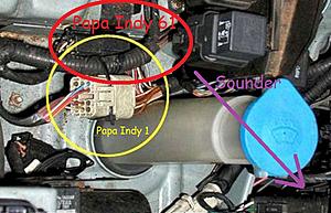

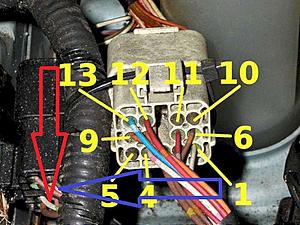

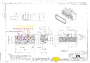

Most of the ECU wires with some exceptions go through the firewall with no firewall connector . Red arrow in pic
The ECU is by the right passengers right foot behind a small wall panel
There is 2 connectors together that has a history of corrosion issues , easy repair yourself and can put in temporary butt splices .

So I went to check it out this morning. Seller firm on $800, and it just needed too much work for me given that I already have another project car.
Undercarriage was clean. One corner on the passenger front had rust showing, but you couldn't poke through. The wiper cowl area was indeed bad. Not punctured, but I could have poked through it with a screwdriver. It would have looked like this: https://www.jaguarforums.com/forum/x...-photos-87131/
Given that I can't weld (yet), this area would be an issue.
Rest of the vehicle needed little things. Motor mounts were also shot, he didn't have the key fob so sometimes the immobilizer would kick in, and of course the throttle body issue. The interior needed lots of little trim pieces too, and he did some wiring already to make the seats work, which scared me away since I don't want to chase after his work.
If anybody has the ability and familiarity with these cars, let me know and I can give you his information. Car is located in Williamstown, NJ.

To me this looks more like a borderline parts donor car. It could be brought back, but the cosmetics are very expensive and that all appears to be in very poor shape.
Cleaning the TB on the XJR6 is a pain. On a good car, you can keep in good spirits, with a car in this condition, you might lose your patience
