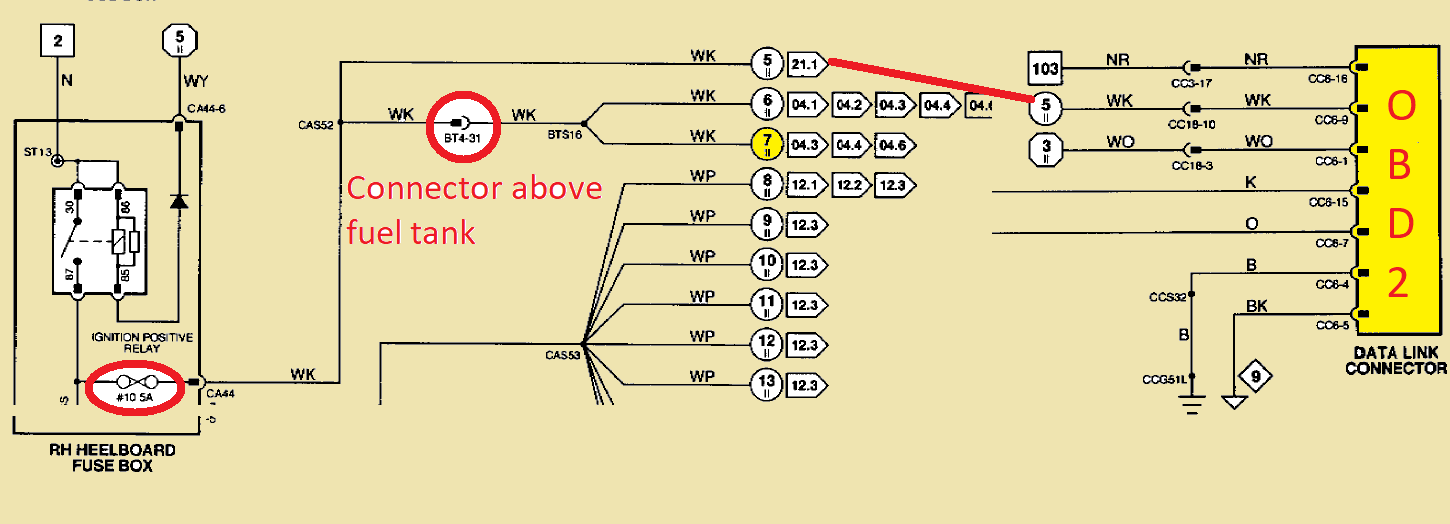

Old Nov 19, 2018 | 11:21 PM

Red / Yellow wire is between the relay and fuel pump as the power to the pump
Touching this wire color to B + should run the fuel pump
A solid Red color would take more research
Bob mentioned some time back of a isolation relay to the Body Possessor Modual removed after shipping but the official color is White ref wiring guide
Go ahead and swap the RH heel board fuse box king relay with the LH engine fuse box relay ( horn )
and the FP ith the Acc relay
With the key in the on position you should feel them clicking during swapping , Hit the horn before swapping to verify the relay is good
Id you eant to
To make the FP relay close it is looking for a ground at Black 19 at the ECU provided by the ECU , The designed in inhibits are told to the ECU
