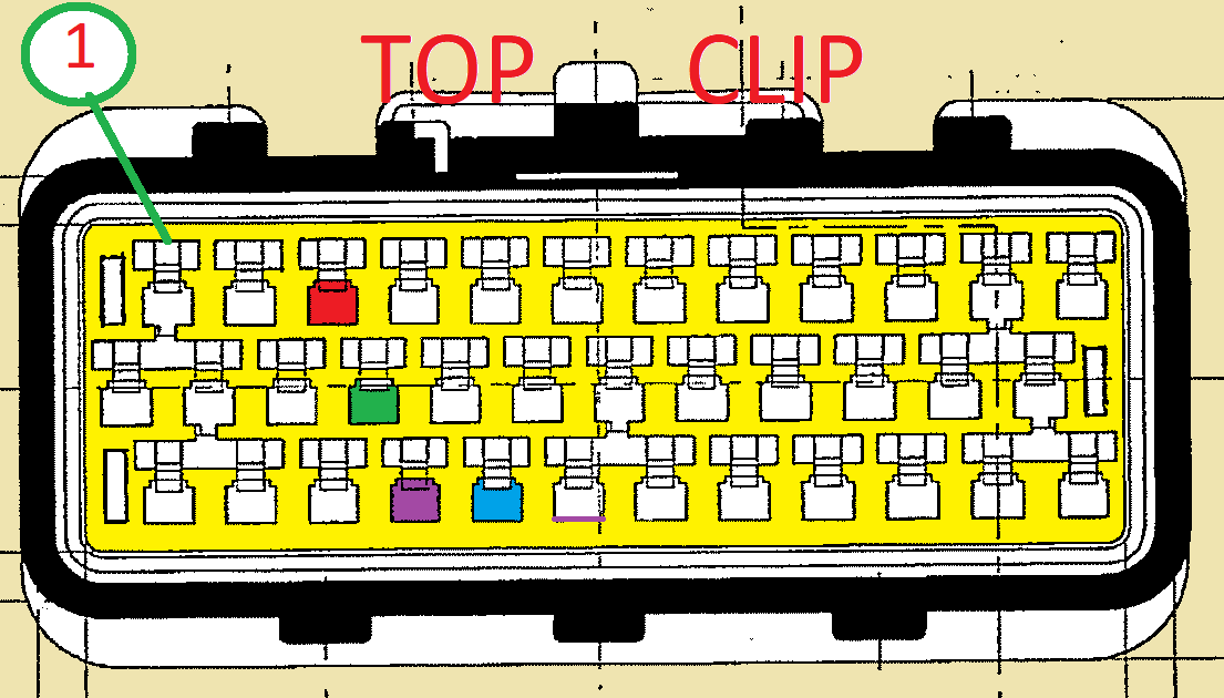

The IAC valve does not have a sensor the verify it is in the position commanded by the ECU
You can put a meter on the ECU connector ( the black one ) and test the legs or windings of the step motor but it probably won't fail unless the step motor is warmed up or tapped on
See page 88
See page 88
www.jagrepair.com/images/Training Guides/801S - 2000.pdf
