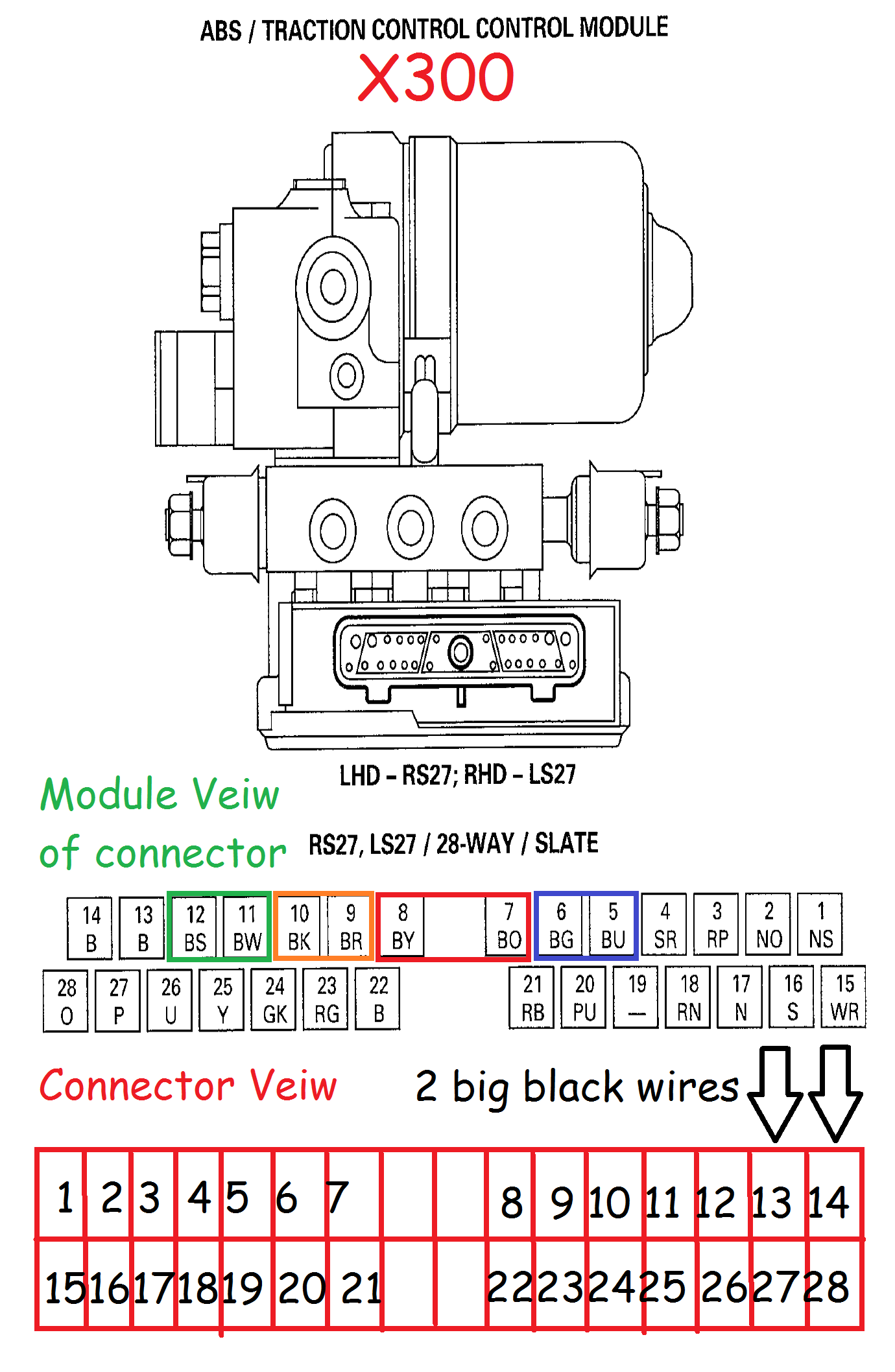

The face of the sensors pick up debris that cloud the sensing signal that is easily cleaned . You don't have to jack the car . Best to spray the sensor bolt and hub / sensor contact area overnight so they especially the plug comes out . You don't want to break the plastic part ( I broke one of mine ). Just clean them off when you get them out . Replacement sensors changed part numbers midway through X300 production the lefts do not work on rights from what I've red on this forum . If you want to put a meter on them to see if one is out of range ( 1300 ohms if I remember ) you can unbolt the module connector and read socket pairs 5-6 LF 7-8 RF 9-10 LR 11-12 RR but the generated signal it makes is pulsed shape you can't see without spinning . Since your light is intermittent I would not recommend spinning them for the work involved . As far as the harder Modual repair it is not that bad for some split them open around the seam others just drill a large hole to re-soldier the common trouble point . See pic below for the point . Just glue over the hole after . see topic
https://www.jaguarforums.com/forum/x...c-fault-44272/
Thanks, Joe
