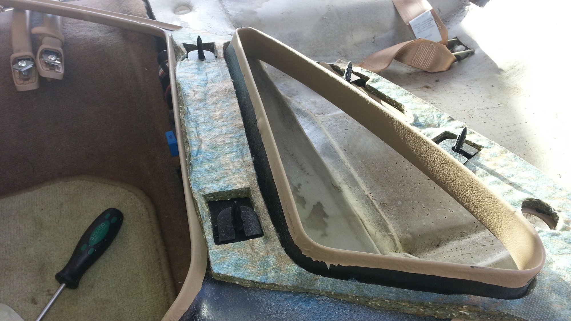

Here's the rear part of the trim. I haven't got a picture of the reverse of the front one, but it's much the same. Don't forget to remove the grab handles.
