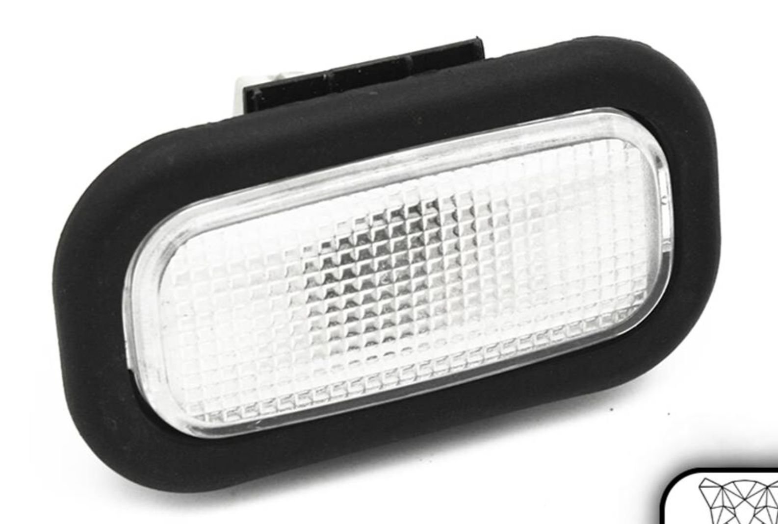

Thank you, I found these on a site with that part number, does that look right.
Regards
W

That looks like it could hold the light in better than the design on the X300. The plastic bezel panels on mine are epoxied to the trunk liner and not as secure as I would like.
I had a look for the X308 version, but couldn't find much of a difference. Do you have a part number for the one in the image?

Yes I googled the number given by yourself! It lines up with chassis numbers etc, but I’ve no idea, in the hole where mine should have been there are surrounds on the inside, epoxied in, don’t know, I guess they self tap into the rather flimsy surrounds ?
I have to admit, that on what you think is a very high quality car, there is a lot of 'botching' ie glueing, Mickey Mouse fixings etc behind the scenes. It takes me back to my working days, when I worked on very high priced luxury motor yachts, when you took the panels down, it was often diabolical behind them. Gluing, epoxy, bits botched up. Still the outward appearance was good.

I thought the same, but they shouldn’t move too much once they’re installed. In fact I don’t think I have done much with them since I removed the original glue and epoxied the panels back in a couple of years ago.
It is a very flimsy way to attach the lamps, which is why I liked the bezel you see in the image.

Just received the replacement lamps, they are a perfect fit in the hole and with correct connector ready to plug
in, unfortunately the surrounds were broken, the retaining clips have broken off, all but 1 , despite being packaged as if new, ( they weren't new or sold as such) but it was not difficult to glue them in place, just a pain. They only cost €19 each , about 19$ US, so not big deal.
I can supply the dealer if anyone wants the link.
