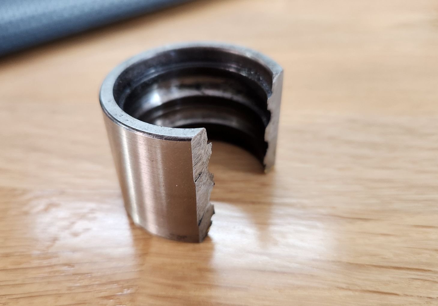

The front bottom shock bushes can be replaced in situ. (You would need to remove the springs again and the lower wishbone arm to use a press or a vice)
The traditional threaded bar and sockets or bush remover tool works just fine without removal of the arm. For the receiver, you will need to cut it to a C shape as the wishbone arm does not have enough space around the bush at the bottom. I made a tool from an old inner bearing race.

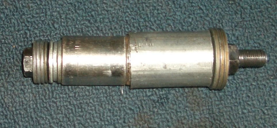

I have done this a couple of times mainly because the OEM bushes don't last very long. I R&Rd the bushes in situ and rather than lots of words the attached pix should explain it.
I supported the car on jackstands under the body jacking points and used a trolley jack under the lower suspension ball joint to support it while I had the lower shock mount disconected.
I eventually got sick of replacing the OEM bushes and having them fail so I made some replacement bushes using the metal parts of the old ones and some poly bushes which fitted nicely and they have been in service for around 20 years with no issues.
Cheers,
Jeff.
You can see the lower ball joint supported by the trolley jack and a piece of wood with the bush puller in place.
On one side is a suitable socket and on the other end is a piece of thin walled pipe. The old bush is still inside the puller.
This illustrates the problem with the bottom shock bush well, I've opted for a slightly different approach in the past by simply grinding a couple mm of the bottom wishbone with an angle grinder and therefore allowing normal socket to sit in there, either way, this is the only way to fully remove the old bush and press the new one(they are a tight fit), without either grinding the wishbone off or using this C shaped receiver you will not be able to press the bush in fully and it will cause it to wear quickly.
