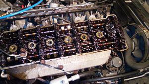

Default Photo showing internal condition with cam cover off
Once I discovered the issue with the dismal engine compression I decided to remove the cam cover to see if by chance the timing chain had broken. I know when I bought the car that the previous owners were terrible about changing the oil in a timely manner and as a result I knew there was some sludge build up but even I was surprised by the amount.
BTW, the timing chain was fine.

That engine is really gunked up!

That is some terrible gunk. Seems like it would take a long time and a lot of neglect to accumulate that much. But the AJ16 is so tough that it is probably mostly unaffected by it!
From the beginning of the crank-but-no-start issue, knowing now that fuel has been flowing, the cylinders have been washed down with a lot of fuel, leading to loss of compression. You added oil to all cylinders, correct? I don't have first-hand experience doing this but others here have. Maybe with multiple oil injections, compression will continue to improve?
Of course this does not address the first issue of not firing during cranking, which then leads to cylinder wash. But, one thing at a time.

Sorry about the P.M. but I hit the send icon before entering text . I'm with SleekJag12 on that it may be a bore wash scenario . With the excessive blowpass gasses cooking the oil as the crankcase vapor swirling around and then getting separated back out into a liquid as a way of explaining the gunk . The unburnt fuel being pushed past the rings into the crankcase into the oil pan diluting it is certainly not good as well .
I would recommend changing out the oil with probably 2 oil changes ( cheapest is fine for the flushing ) to get this compromised oil out before it compromises your main bearings and crankshaft / piston rod journals . After the first oil change I recommend using a product call Reslone to remove any possible blocked oil passages and varnishes in critical areas like the journals .
As to the borewash / compression use the same Rislone on the top of each cylinder and turn the engine through to force it into the area of interest which is the rings as well as coating the cylinder walls and let it sit for a day or so .
