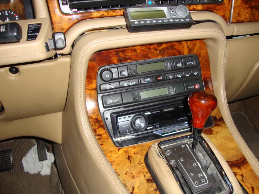

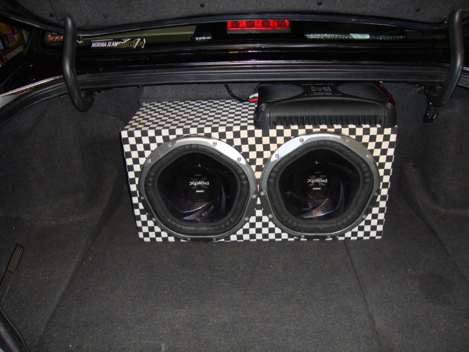

go all out
Old Mar 23, 2011 | 09:07 PM
panchostatus's Avatar
Joined: Nov 2008
Posts: 279
Likes: 6
From: Columbia, SC

Nice setup Pancho. How are those slappin in the car? I only got 1 12'..I didn't want to get much rattle in the trunk but the 12 doesn't really hit hard through the metal frame which is slightly disappointing. I do have nice crisp sound with some thump though.
