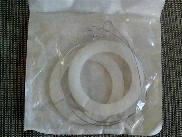

This is what I found on Ebay some time back , need to confirm the correct kit
I never done the job
Editing
on ebay i found in USA 35€ + 35€ postage!
but can´t seem to find anyone on my country willing to do the job with efficiency and capable of giving me a warranty (of 3/6months).
