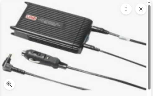

Usually VCM takes power from DLC/OBD2 port of car, but you can also use power supply from IBM which (works also for Panasonic CF-18) IBM Thinkpad 16V 4.5A eg Part Number 02K6746
So then eg during programming newer cars IDS/SDD doesn't require so many Ignition key On/Off/On - cause VCM can turn of power from car as itself is separately powered.
Somewhere in history they have delivered also these LIND Power supplies (funny co-incidence ;-) to be used from cigar lighter: Lind Electronics GE1950-2304 FB DC Automobile Adapter
Like these on eBay https://www.ebay.com/itm/167016183791 (which are missing VCM end connectors)
