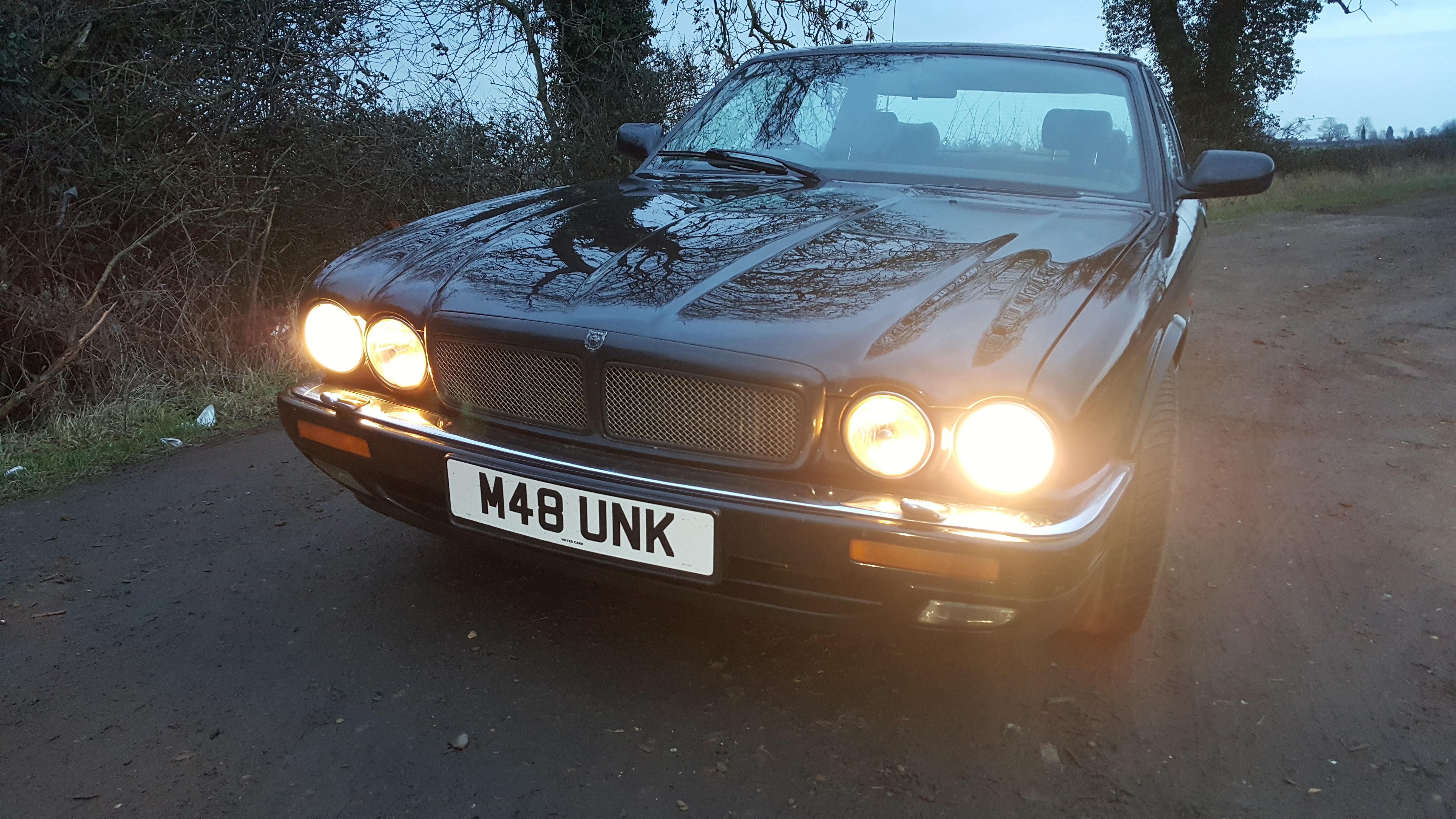

Fitted X308 head lights (dipped beams were cloudy & one had a cracked lens)

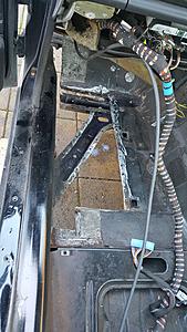

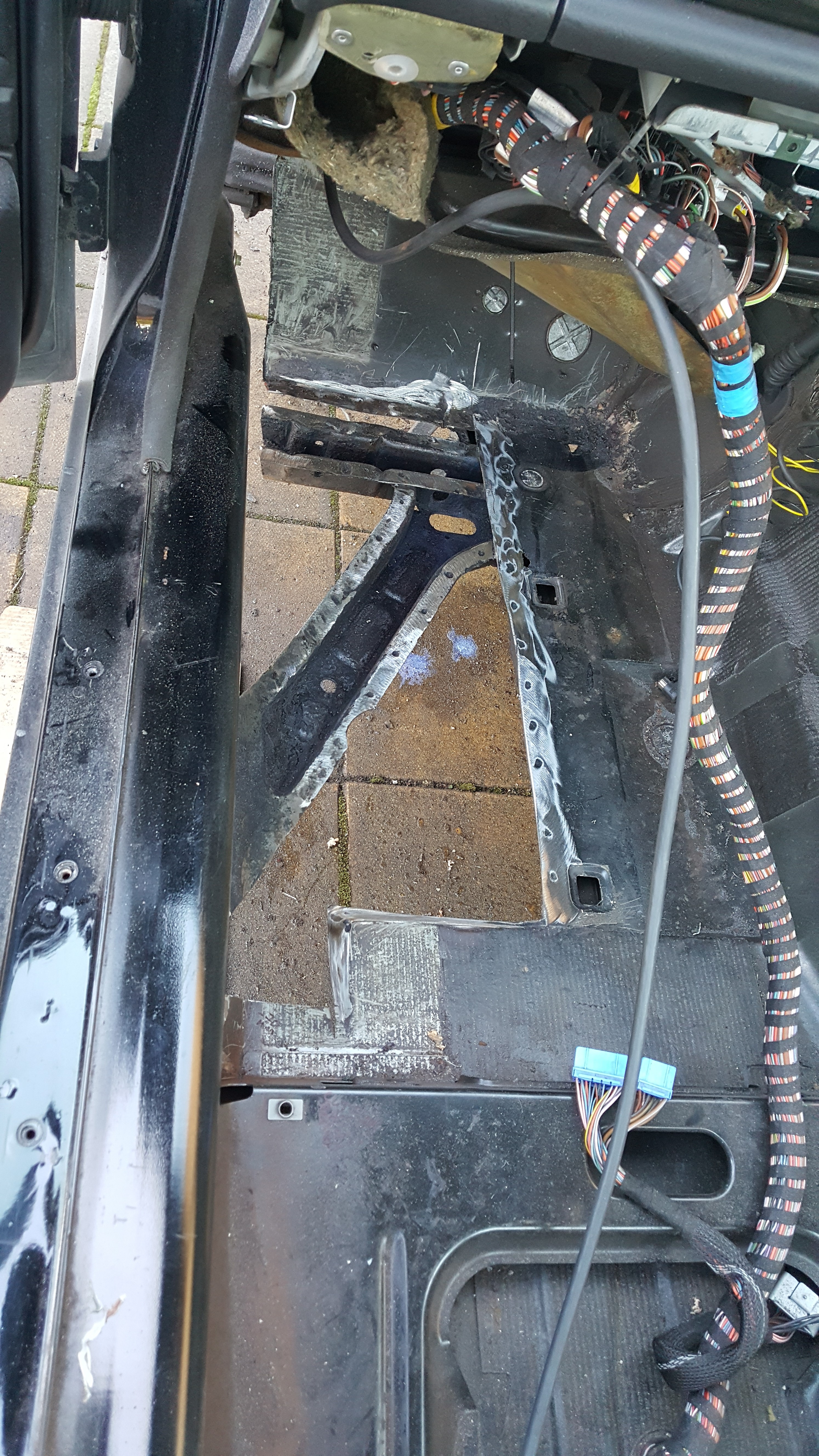

Rust repair - this was a biggy, it was worse than I expected and I needed a little thinking time after the initial thoughts of breaking the car. I've replaced the front LH front floor pan & LH sill repair (inner & outer), footwell repair both sides, repair to top of bulkhead on the LH. inner front wheel arch repairs (rust propogating from the liner mounting holes), RH rear wheel arch inner (at the back) repair. Replaced the rear subframe mounting brackets, the early type without the drain hole had rusted well

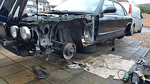

Here's a couple of more scary picture of the LH floor pan for the before, during & nearly at the end - I forgot to take pictures once it was all cleaned up, sealed & painted, as I was just trying to get it finished.

The headlight washers were on the car when I bought it. I just assummed they were original fit?
The X308 headlight swap is easy. I just bought the complete units with the mounting brackets from an on-line breakers, see attached photo. You need to get the harness connector blocks too, as they are different between the X300 & X308. They came with the bulb, which are also different. The connectors need to be swapped over and the wiring colours are different. You need to either cut & solder the wires between the two, or get new crip connectors for the blocks.
The colours are:
RH
CAR - X308 light connector
Black - Black
Black - Black
Purple/White - White
Blue/Yellow - Blue
Blue/White - Orange/Yellow
LH
Black - Black
Black - Black
Red - Red/White
Blue/Yellow - Blue/Yellow
Blue - Blue/White
