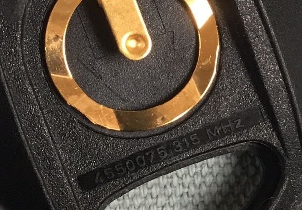

****UPDATE FOR MY FELLOW AUSTRALIAN X300 OWNERS****
I started this thread with the intention of wiring in a third party central locking remote system.
However, in the mean time.....
I was also looking to source a compatible key fob from another auto maker that I could pair with the x300 Jaguar.

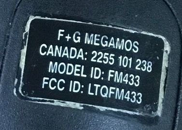

As a lot of you probably already know, the only compatible key fob is from the 900 & 9000 series SAABs. These fobs are known as LTQFM433 (only 433MHz is approved for use in Australia)
I was hesitent to try one as the cases are all marked 315MHz under the battery cover....yet I have recently seen some circuit boards online are marked FM433.00
Now, the fobs used in the American market have to be approved for use by the Federal Communications Commission in the USA...and the fobs have to display this approval. Also, fobs in the USA usually 315MHz.
So, I took a punt and purchased said SAAB fob with the FCC ID: LTQFM433 approval label. When it arrived, I opened her up and checked that the circuit board was marked FM433.00.....and indeed it was!

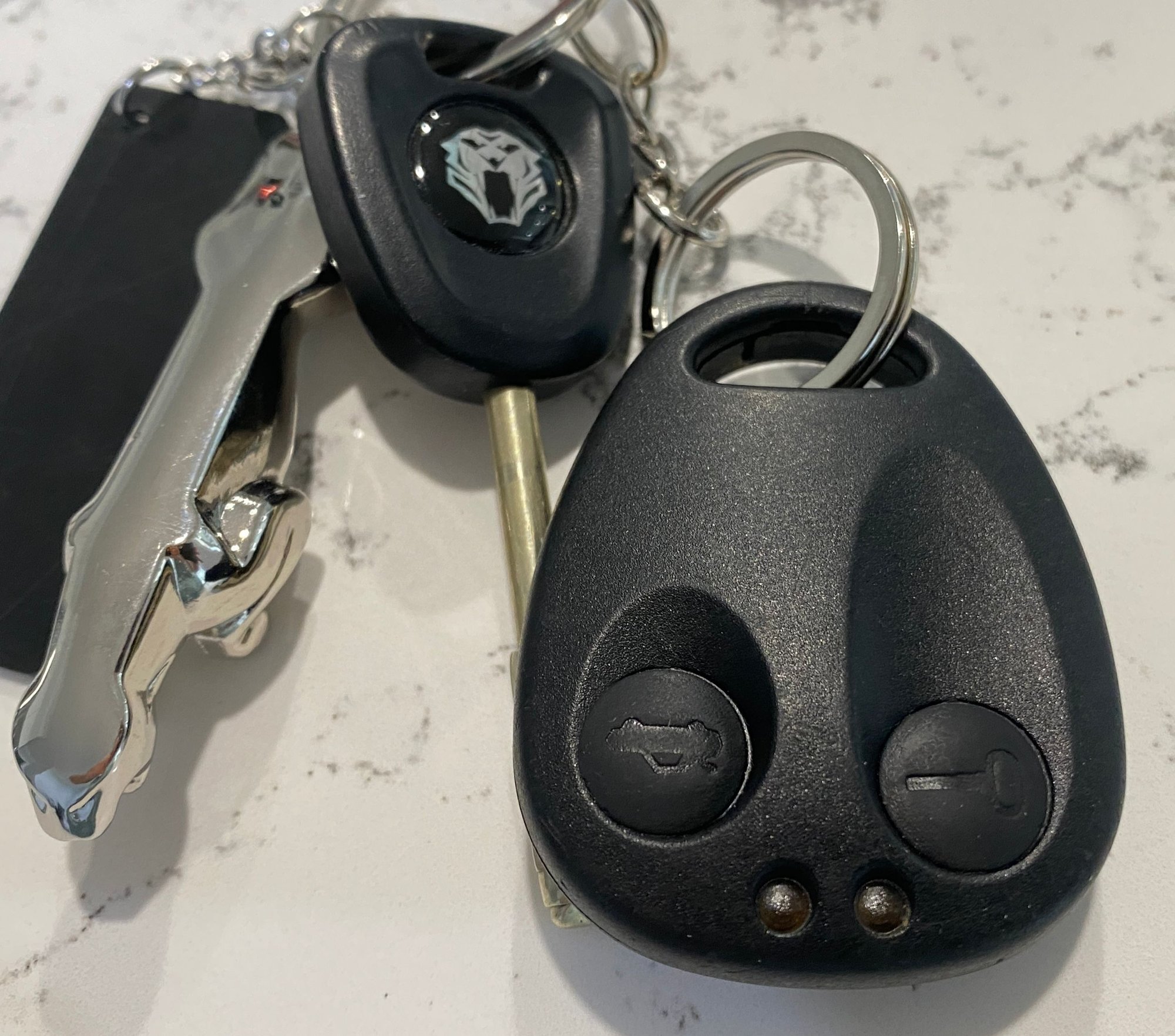

Paired it to Josie the Jaguar and all works....I'm of course stoked!!
Bottom line is that, especially for Australian owners, these SAAB fobs will certainly work with our Australian delivered x300 Jaguars.
They seem to be more readily availsble online and more affordable than the old original Jaguar fobs of the era.
Sorry, if all of the above is already common knowledge in this forum...but I was much relieved to know I didn't have to go forward with splicing in a third party remote central locking kit.
I was not particularly looking forward to doing that!
HAPPY DAYS!!
315MHz is molded into the plastic case...yet it transmits at 433Mhz - confusing....
315MHz is molded into the plastic case in the battery compartment...yet it transmits at 433Mhz - confusing....
