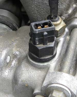

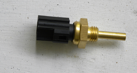

Hi there
Car: XJ6 1995 (December 1994 production)
Problem : I want to replace my water temperature sensor (on thermostat housing) and I got the new Jaguar part LNA 1600AA but the electrical connecting system is totally different. the old one is a short male/female connection. the new one is a much longer and differenr.
So 2 questions
1 - does anyone would have (new or used) a female connecting plug for the new sensor?
2 - Or eventually I can modify the old female connector to fit the new one but I do not knpw if there is a plus and a minus type thing on the male prongs of the sensor. I would hate to burn something by not making the right connection. can some one help here?
Thank you so much.
See attached pics
Claude

You have bought the wrong part. The part no. you stated is for X300 V12 not the straight 6.

Thanks for your follow up on this but according to Jaguar Classic Parts this is the correct part number:

Using that source I come up with LHE1600AA
DD

Ditto with Doug
