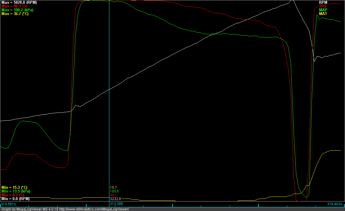

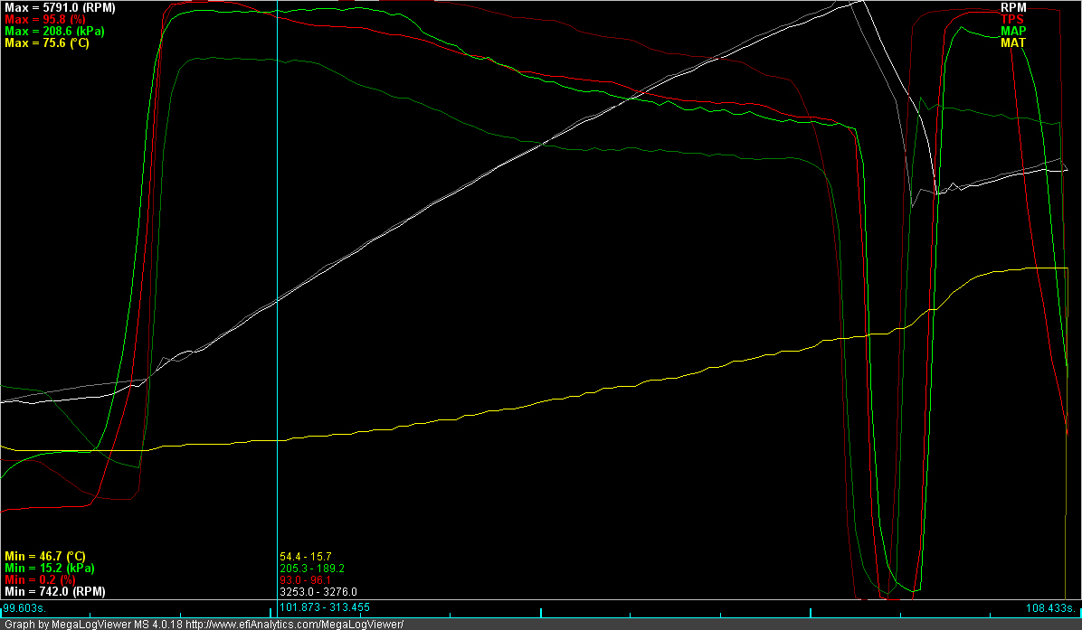

Have some graph pics that maybe could be of interest on this boost-temperature-power topic. Or eventually add some more confusing or contradictory aspects.
Should add that this XJR6 engine is not in an X300 but in an old series1 car using a standalone, speed density ECU. No spark retarding from knock or inlet temp is enabled.
The pictures is from logfiles taken after I had done some minor, not very professional home porting of the M90.
First pic, (red trace throttle, yellow inlet temp, green boost, white rpm) is from a log during a short WOT in third gear (5-sp), showed an impressive max reading of 208.6 kPa (15.7 psi). Seems to have been a very effective porting indeed, an increase with about 20kPa!
Until noticing that the max temp reading was 75.6 deg C (168 F). And no, not the engine coolant but the MAT, inlet manifold air temp.
Found out that I had messed up things when refilling and bleeding the IC, water had not circulated at all.
Added the required coolant and, next day, did a new quick test with log. Same road, same 5 deg C ambient winter temperature. Could of course have been some small differences in wind, humidity or baro.
Pic 2, very different numbers. At the 3200rpm range temp is down from 54.4 deg C to 15.7 C, (130F to 60F) and boost has dropped off from 205.3 kPa to 189.6 kPa (15.3 psi to 13.0 psi). Very similar to what was seen before the sc porting.
Pic 3 is booth pics in one, no 2 overlaying no 1. Very interesting thing is that the white rpm traces are more or less paralell, no changes at all in rpm/time accelaration.
