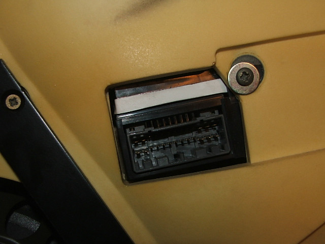

How do you get to the little buggers?
I've removed the leather and wood trims, but now I cant get the plastic casing out. I removed the little screw (indicated by the red arrow), and the front lifts up, but the back is firmly restrained...

I haven't had my door panels off in over a year now, but last time I had them off I believe I noticed that they must be removed from behind the panel (they are fastened on the inside). Someone can correct me if I'm wrong but I'm pretty sure that's how it was. I can remove my door panel tomorrow to check if nobody else chimes in

Don't worry, that door panel pictured is already off.
Well I was hoping the door panel didn't have to be removed just to get to the backlights (it's an incandescent bulb for christs sake - a part with a relatively short lifespan, so what kind of idiot designs it in so you have to take the whole goddamn door apart to replace it?).
I can't really see any access point on the back of the panel, so I guess I have to split the two layers (ie. unscrew that whole storage pouch thing).
I was really hoping there would be a proper access point for servicing these lights. I want to put LEDs in there, and now I'll have to take apart every door!
EDIT: See, here's what it looks like right on the back of the trim panel:
Doesn't look like you can acces the lights from there, meaning you have to take the trim panel it'self apart?

Yes, the door panel has to be disassembled to remove the switch. It takes only a few minutes. After you've done the first one the others will certainly be easier.
On the bright side you can admire how much much the door trim panels were improved in terms of the quality of materials and construction versus the older Jags....if you ever owned one.
Perhaps you could post a pic of the actual bulb replacement? I *think* you have to open up the switch. At 15 years old all my bulbs are still working but sooner or later I know I'll be faced with the same task.

EDIT: I'm an idiot. After taking the whole door apart, I discovered that there was an access point for changing the bulb. All you have to do is take off the leather and wood trim, and right there (on the left side of my arrowhead) is a little piece of translucent blue plastic. Lift it up, and out comes the light.
