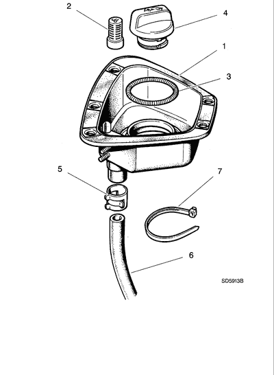

Good work, Bill!
We'll look forward to your next update!
One thing that comes to mind is to check the drain tube in the fuel filler box, part 6 in the diagram below. The drain tends to become clogged with seeds and leaves, which allows water to pool up around the fuel filler neck when it rains. If the fuel cap gasket doesn't seal perfectly, water can make its way into the tank. It's simple to clean the drain tube with a combination of string trimmer line, a vacuum cleaner and compressed air. Just take care with the air pressure so you don't blow the tube off of the fitting on the bottom of the fuel filler box and create more work for yourself:
Cheers,
Don
