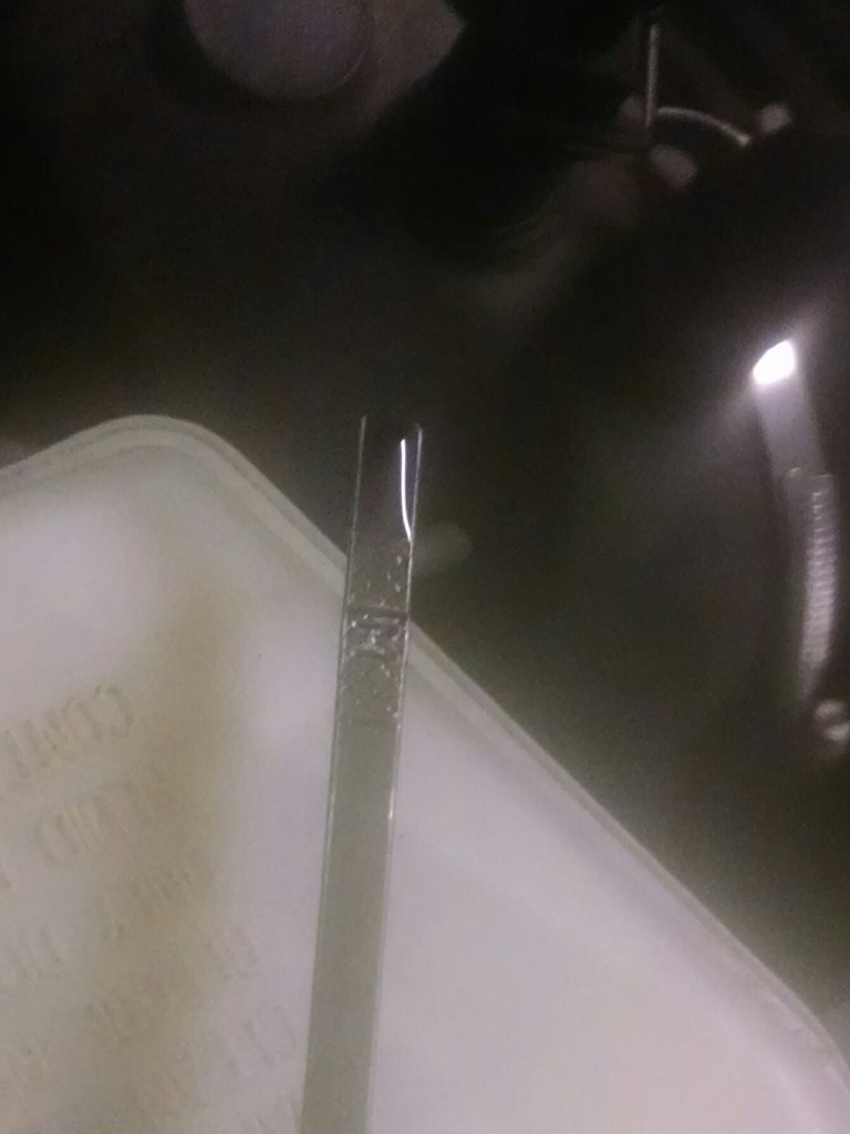

I took time to document this weekend's top-up:
Here we are just a fuzz above the min X-hatch mark:
Addition of (near-as-makes-no-difference) 1 US Quart* later, and I'm a fuzz short of the "M" mark:
*Using a gallon jug, filled to just above the 1 Qt mark - dumped it all in and let it drain a few mins, not really sure how much remained clinging to the sides of the jug.
