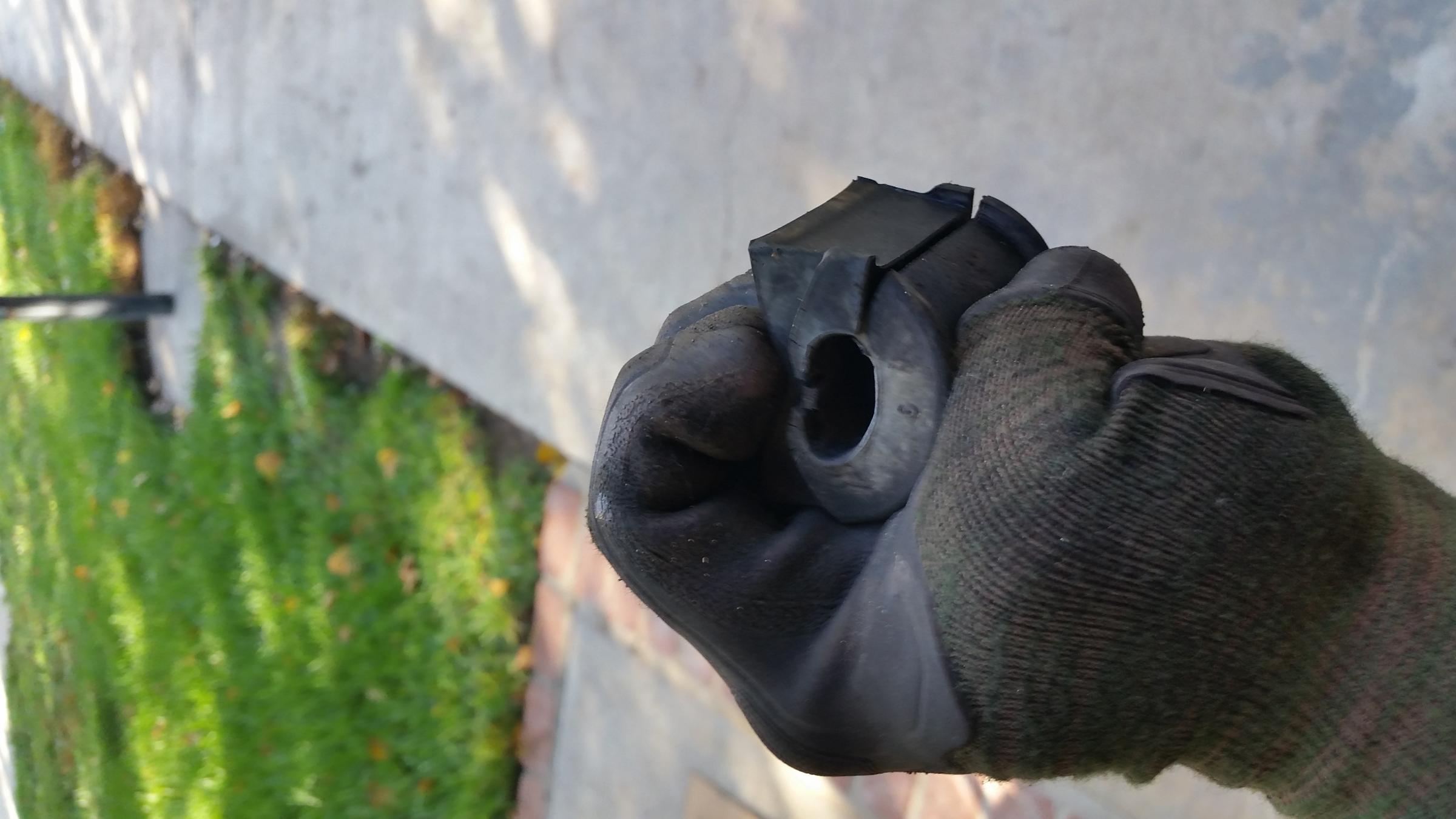

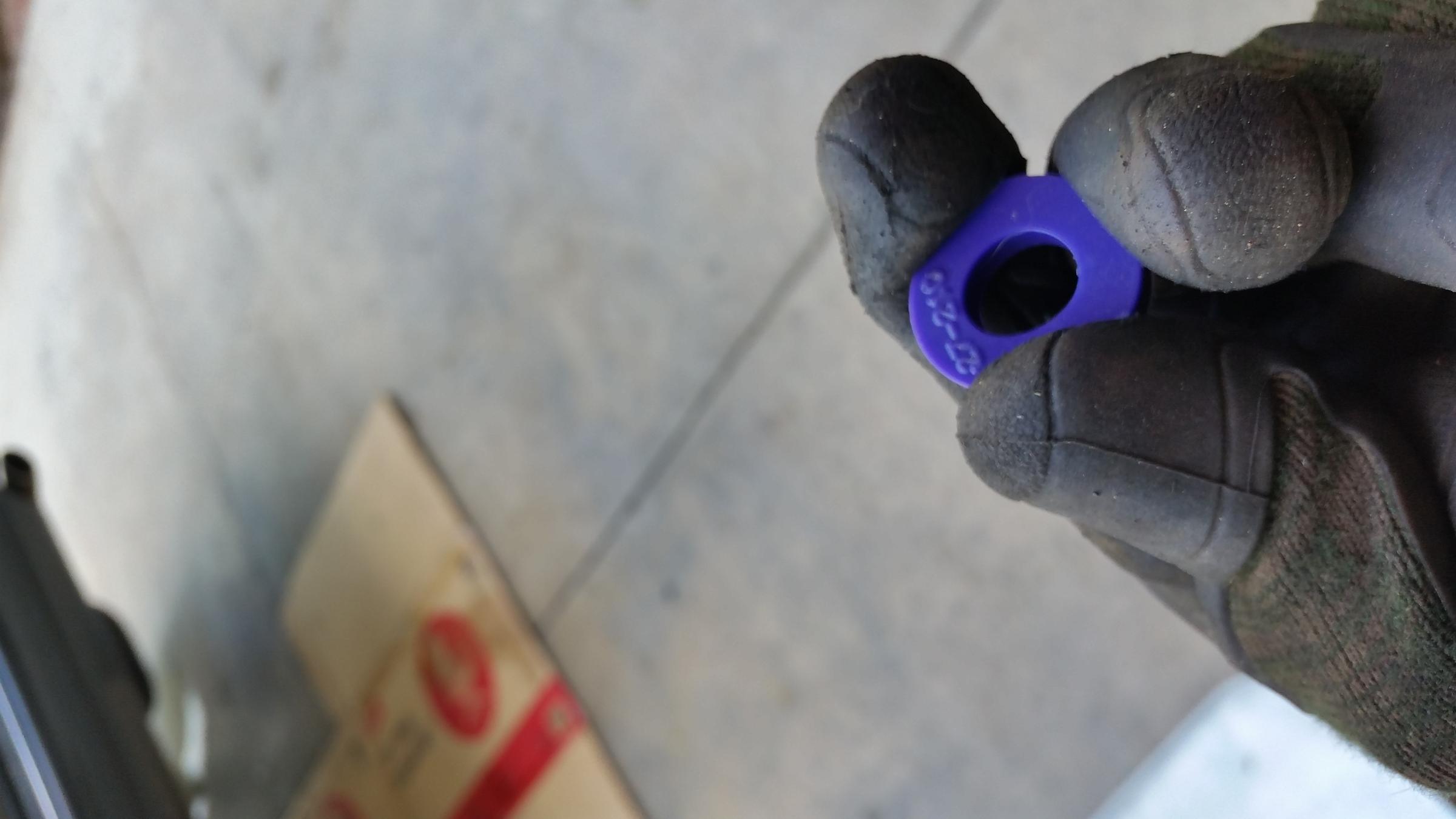

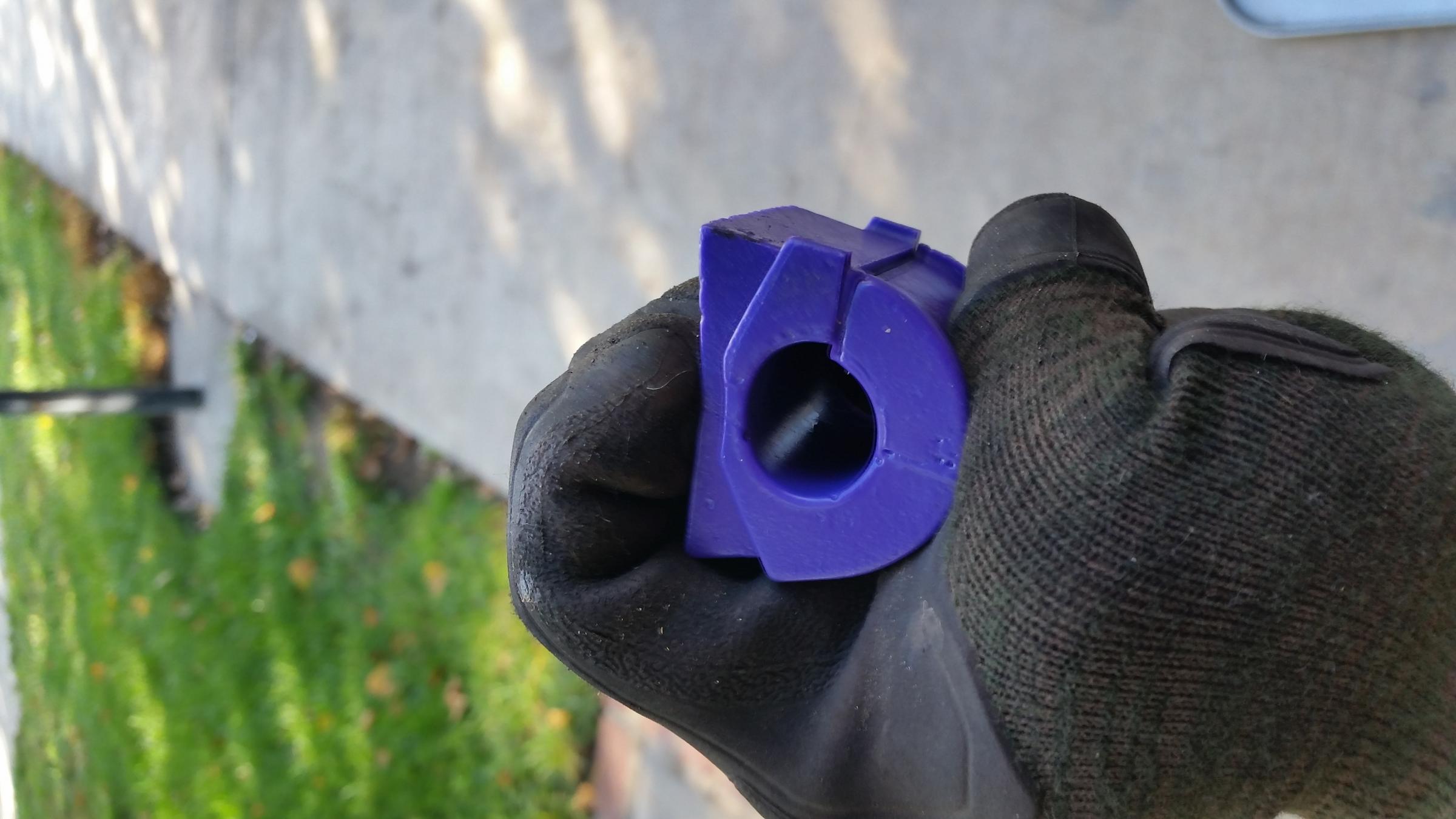

Got the new bushings installed today. Didn't get a chance to do the front lower shock bushings but I was able to install the rear anti-sway bar and the rear link bushings.
I've uploaded pictures trying to show the durometer of the old bushings and the new polyurethane bushings.
Each picture showd me trying to squeeze as hard as a could. Not sure if this would show the same results with brand new OEM bushings as the sway bar bushings were badly cracked.

Old Nov 3, 2014 | 09:16 AM
al_roethlisberger's Avatar
Posts: 3,750
Likes: 688
From: Sanford, NC
Thanks, will be interested to see how easy/hard it is to replace the front lower shock bushing, getting it out of the wishbone, and getting the new bushing in.
I've seen several threads covering the install of the front shocks, but none I've seen covered replacing that lower front shock bushing.
So, after replacing the rear sway bar bushings with poly, notice any difference?
There's still that one rubber metalastic bushing integrated into that sway bar end link top eye, so I guess the only way to really eliminate that would be to switch to heim/rose jointed links. You'd have to fabricate those yourself though, which wouldn't be hard, just trial/error.
