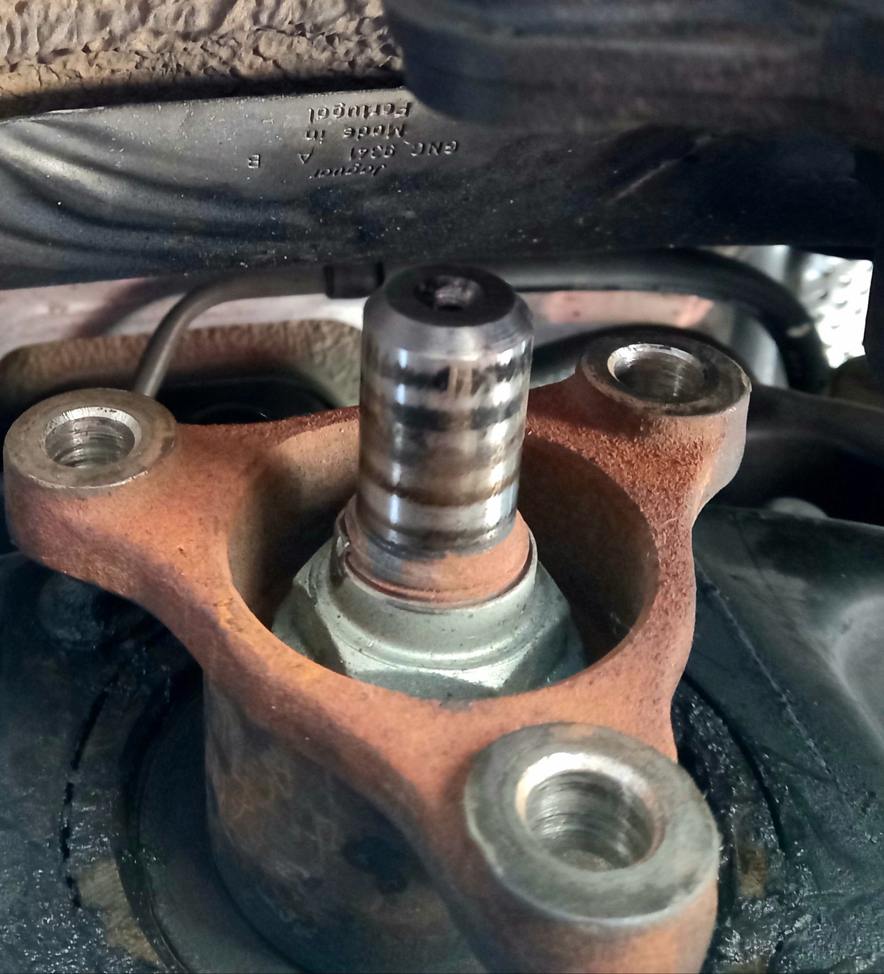

About 4 months ago I b

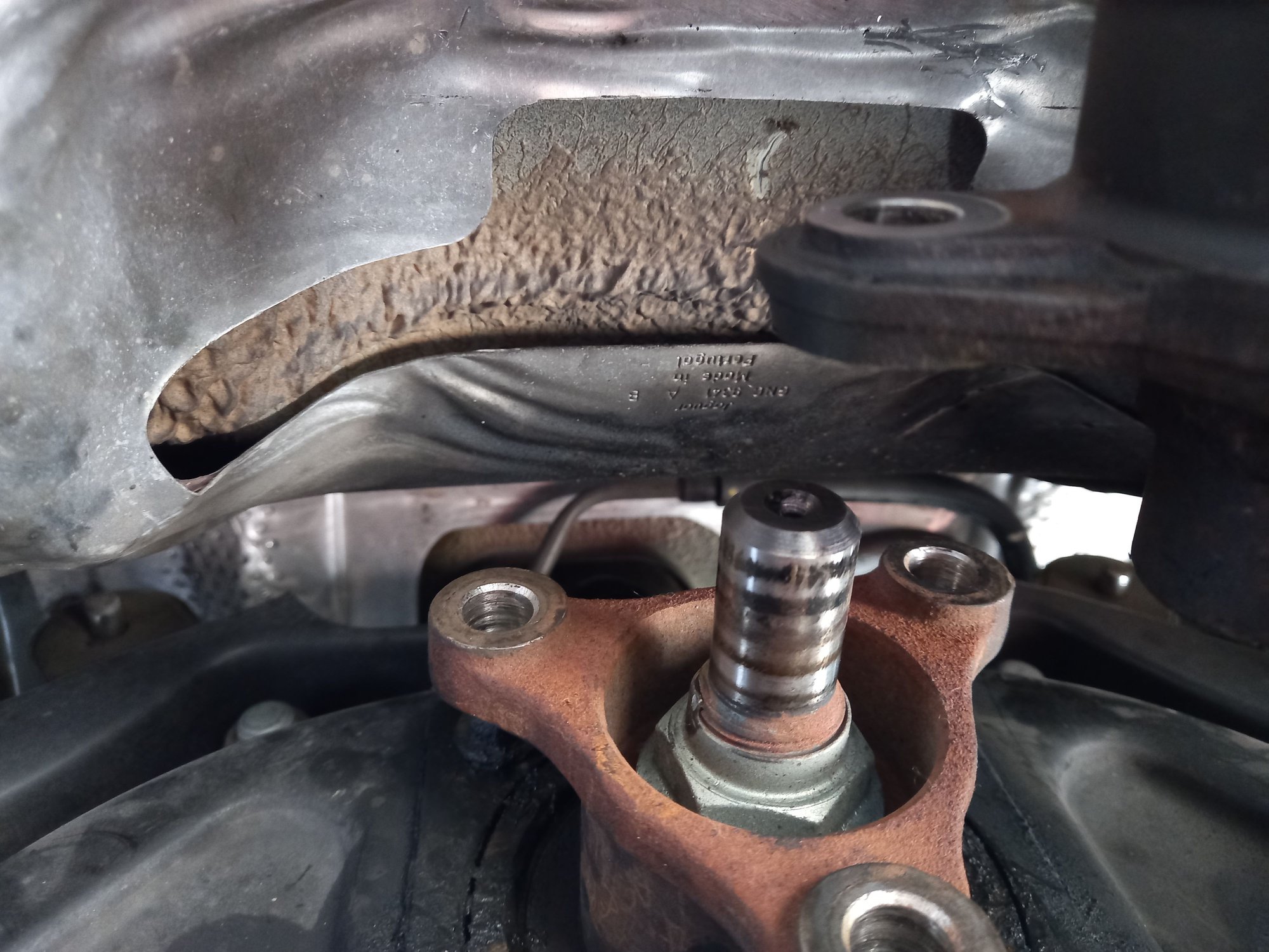

ought a 1998 XJ8, 69,000 miles. There was a noise coming from the rear end that sounds like a worn brake pad rubbing against the rotor. The noise only happens above 50 MPH and gets louder as speed increases. The sound is constant and weaving left or right does not change alter the sound. So far I've checked the parking brake shoes and adjustment and checked by gently applying the parking brake at speed with no affect on the noise. I've replaced the following, rear brake pads, differintial fluid with 75w140, left and right inner and outer wheel bearings and races, all 4 axle ujoint. There's no play at the rear wheels at top and bottom or side to side. I checked the output bearings by prying between the diff and flange and there no play. I thought it might be a bad pinion bearing or loose pinion nut so today I pulled the jurid coupling and checked the pinion. No up and down, side to side or in and out play. The pinion had a groove in the shaft and the sleeve on the pinion nut was center punched into the groove so I'm assuming it has not backed out. I did find some wear marks on the pinion shaft where it slides into the driveshaft ( see photo). Is this normal wear or could the jurid coupling be going bad? I cleaned and inspected the coupling and found no cracks. I've put about 2000 miles on the car so far and I'm am still trying to find the cause

Checked the shock seats and bushings along with all the subframe bushings. They all look good. Since the jurid couplings are original to the car and are 23 years old I figure I'll replace them since the rubber may have deteriorated due to age even though they look good. Since I'll be under the car anyway I figured I'd replace the center support bearing. I was going to change the center u joint at the same time but can't get a valid part number. Does anybody have good part number for the propshaft u joint?
I'm still curious about the wear marks on the end of the pinion shaft. There was some residual grease (very black grease) on the pinion stub. I wiped the stub clean so the rings on the stub are discoloration from what I assume ti be wear from the propshaft. I looked at some of the used differentials for sale and none of them have any wear patterns like mine. My thinking is a bad jurid coupling may allow enough play to allow the prop shaft to wobble on the pinion stub and create the marks

Highhorse, I have no idea how many miles were on the diff. I got to inspect it when I picked it up. No play in the input shaft, or output bearings. The pinion seal was dry with no signs of any seepage and no noticeable noises when the input shaft or output shafts were rotated. It did come with a 30 day warranty so for $300 I took a gamble. I drained the diff and the fluid looked new, but the fill plug was not particularly tight when i removed it so my assumption is the salvage yard drained it and threw in some new fluid. The used diff may fail in 6 months....or 6 years....or never. But for $300 the car is bsck on the road. When I get around to tearing down the diff I'll start a thread on it. I've also got a 1999 XK8 so having a spare diff probably isn't a bad idea.
