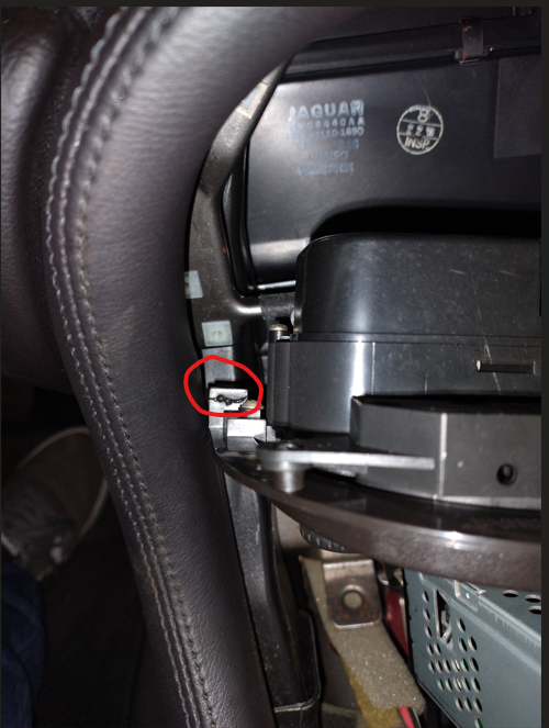

At the same time I was doing this, I took the chance to fix something that was bothering me since I bought the car (I'm the 2nd owner): the AC panel was flimsy on the left side and everytime I push the ON/OFF button, the panel would wiggle.
In case you don't know, and I hope this can be useful for somebody, the bolts to the right and left of the radio/AC panel pass first through the radio hole and then through the AC hole to fix them to the console.
It seems like somebody had been tinkering with the radio in the past, since the plastic bracket to the left with the hole on the AC panel was broken, I heard it falling as soon as I removed the bolt. Fortunately, whoever broke it put it in back place, but since it was not fixed anymore to the AC panel, it did not press against the panel and therefore the wiggle.
Also, on the other side of the panel, the plastic bracket on the radio panel was also broken, and again, whoever broke it had the manners to keep it in place at least. The radio though was not wiggling, even with the bracket lost.
Here in the pictures you can see first the plastic bracket on the radio side (this is the good side, not the broken one) and in the second picture, I circled in red the "repair" I did with Loctite to fix the bracket to the AC panel.
I tried to also glue the bracket of the radio side, but putting again the radio in place is very difficult because the leather surround "presses" against the radio brackets, so the risk of damaging them is high. So, the one glued fell again.
Long story short, be very careful when removing the radio, as the brackets will be on the way and you can damage them.
At least the AC panel is now not moving anymore and the radio works again!

Yeah, this has been an issue for a couple decades now. Sun dried plastics are the curse of these cars. Be sure to put light pressure forward on the wood trim rim from the end closest to you to seat cleanly around the radio and climate controls. This pressure also assists the mounting screws to not absorb all the weight and isolates any movement. When you apply this pressure use a plastic body panel tool, but first loosely put on the nuts for the shifter trim ring. Then apply the pressure and just using your fingers, take a socket to snug the nuts down. Then you can put in the rear screws by hand as well and this should help prevent breakage. It also cleans and tightens up the finish for that area.

Yeah those mounts are damaged on mine too, but once in place it's all solid so I've not sorted it.
If you take it all out & search for plastic codes (I forget the correct term) which are odd symbols on the moulding you can buy special glues to fix them. I've had to do with on stupidly expensive bits of plastic for motorbikes & now have a brush on primer for superglue to stick some of them that superglue doesn't normally work on.
