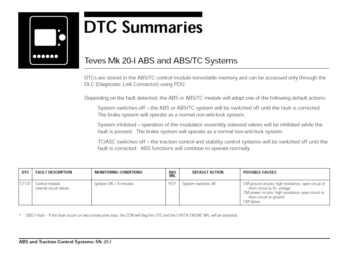

C1137 : here is the extract from the Jaguar DTC listing:
As you can see, the possible causes are simple and jump direct from circuit fault to module failure.
